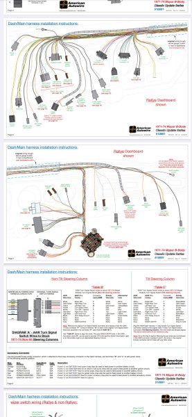

Hey, i have 74 charger se and my front signal lights turn on when I use the blinker but they dont blink. I have changed relay, re-done plug connector, and swapped wiring to see if i may have wired wrong. I have 2 wires, black and black with yellow stripe. I dont want to scratch up the paint to get a better ground unless that's the next thing to try. Any suggestions or prior experience will greatly be appreciated!

I have replaced flasher, and I've added my wiring diagram. And I was looking, so from what I have with this is there's 1 place for my flasher. Since everything is changed, I no longer have that as a placement. But I will have to take my TS switch apart and see if I can jump wire for better connection. See if that works, thank you.

Update, going through wiring and bulbs lastnight. I found my TS switch broke where it flips back and forth each blinker. Seen it wasn't having a solid connection for blinkers, I am going back to original switch. Hopefully it turns out better than the aftermarket switch. Will update after replaced!
