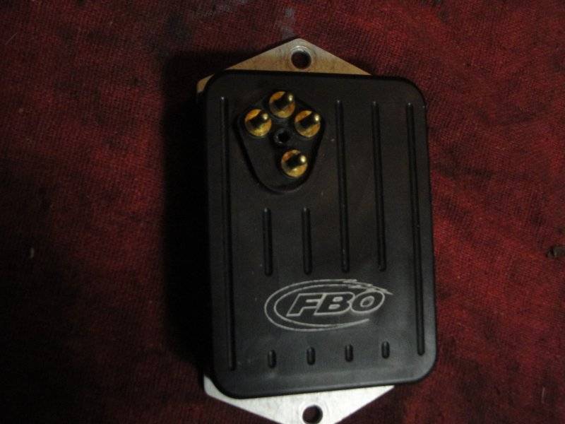

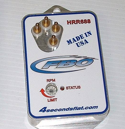

I wouldn't mind switching to an FBO unit if it worked for me. I tried one a few years back and it made my aftermarket tach bounce up and down. I added a diode in the tach wire to the coil but it did not help. My FBO box looks like this:

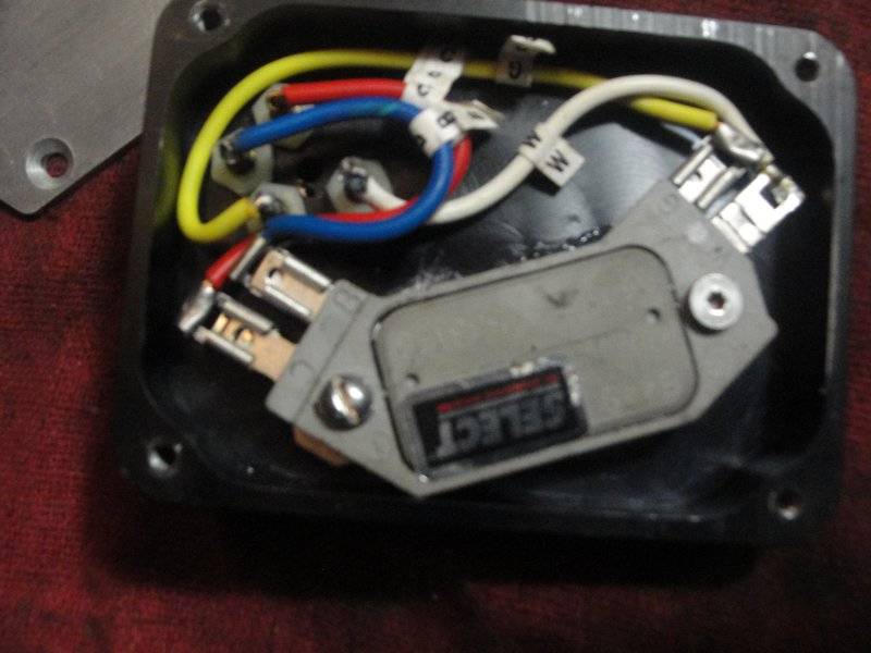

THEN I see these pictures in this thread:
I like the look of the outer case. It will be a turnoff for some guys but I like it. This is a GM HEI module, right?
Is this how they are made now? Maybe this is a custom job someone did on their own? If I knew that one of these would work without messing up my tachometer. I'd be interested. I like the rev limiter feature it had.

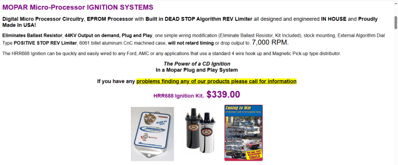

Can this price be right? Almost $340 for an ignition box and coil ???
They still show the natural aluminum finish ignition box.
Lower pic in post #43. Wires are soldered, not crimped. Good! But pick up terminals [ right side ] look to be almost touching. Not good!

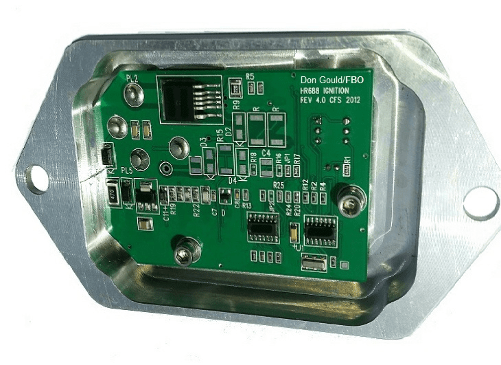

When the original A688 unit was out of production the HR688 unit was offered. Unfortunately was found it was an HEI unit into a fancy box. He stopped the production of those since was kinda some kind of scam for lot of ppl, then they came out with the HRR688 brand new unit which is a diff piece with a completely diff internals built… at least it seems being that.
The original A688 unit was made as far I know by Standard products under FBO specs (per their words), but the production stopped when the Standard manufacturing was moved to China as far I know.

Just drove 450 miles to Chrysler Carlisle and back with my new FBO ECU. Love that is has a great warranty and is made in the USA.
I have seen the new ones, totally different. looks like high quality custom board. Glad some one is making something quality for them. Initial run costs are crazy.

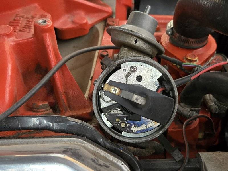

Pertronix
I am running a pertronix in mine for 3 years now, not one glitch or hiccup. I am having Halifaxhops rebuild my original distributor and install a petronix kit in it then set the advance curve. It should look really nice with the OG wire set I bought for it a while back.
