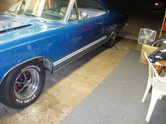

I have a friend with a '70 SuperBee, he says the brake drums on my '70 GTX should be red? Is red brake drums correct for a '70 GTX?
only if you had the factory optioned rims installed. Mine RR came with Magnum 500s from the factory and the face of all four brake drums were painted red
HMMMMMM. MIne has a factory mag style wheel, I think this was called a 'Rally Wheel' back in 1970?
Yep so your drums would be painted red. They were done with a paint brush and not very well.
Is it to be seen through the slots, and match the redline tire?

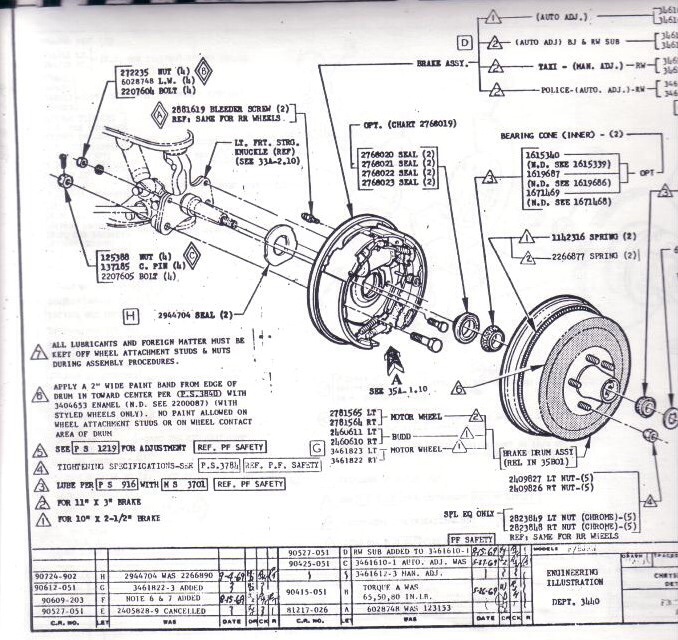

Nice find. I've seen the 69 engineering drawings but not the 70.
The engineering documents have pretty much been the guiding force behind what the wheels were 'supposed' to be painted.
red paint

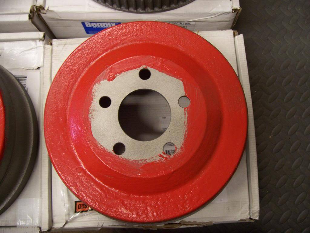

Granted these are over the counter aftermarket ones but the ones on our car were just like this. They were still dated 1968 date codes too.

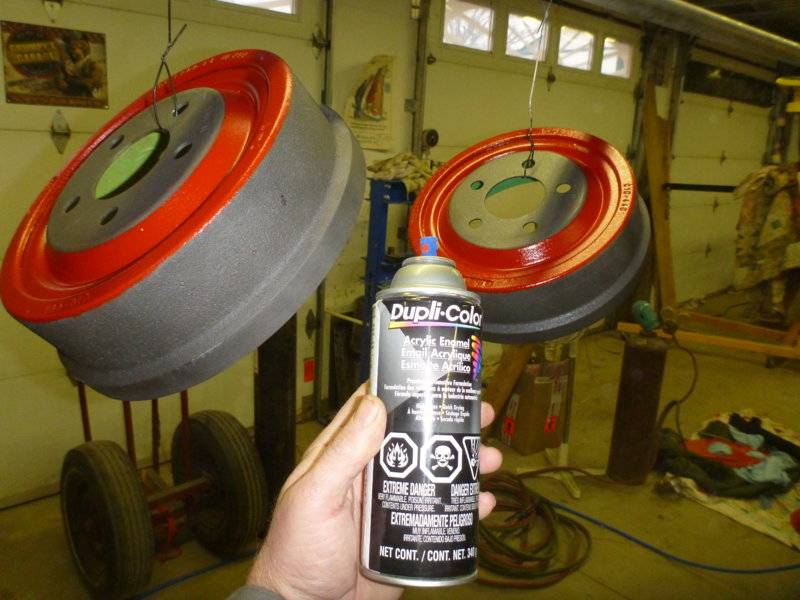

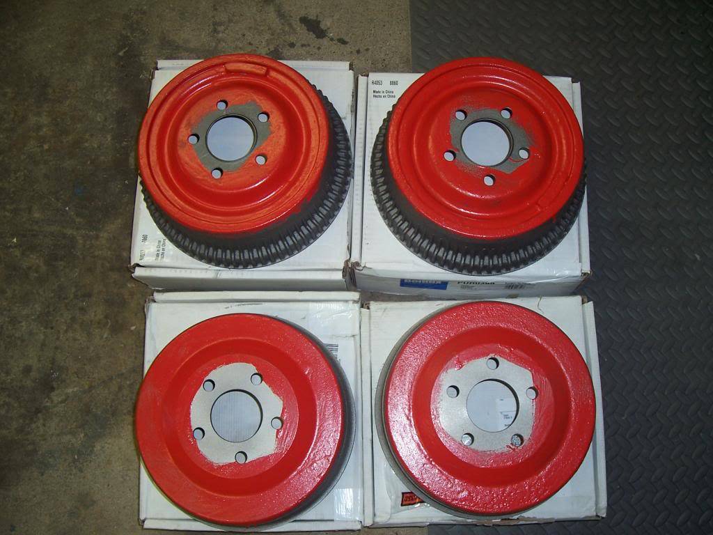

I used a rattle can of Universal Red from O'Reilly Auto Parts.
Ford engine Red if I'm not mistaken.. is what I used after being told that was close.. and then I cleared the entire drum to prevent rusting.

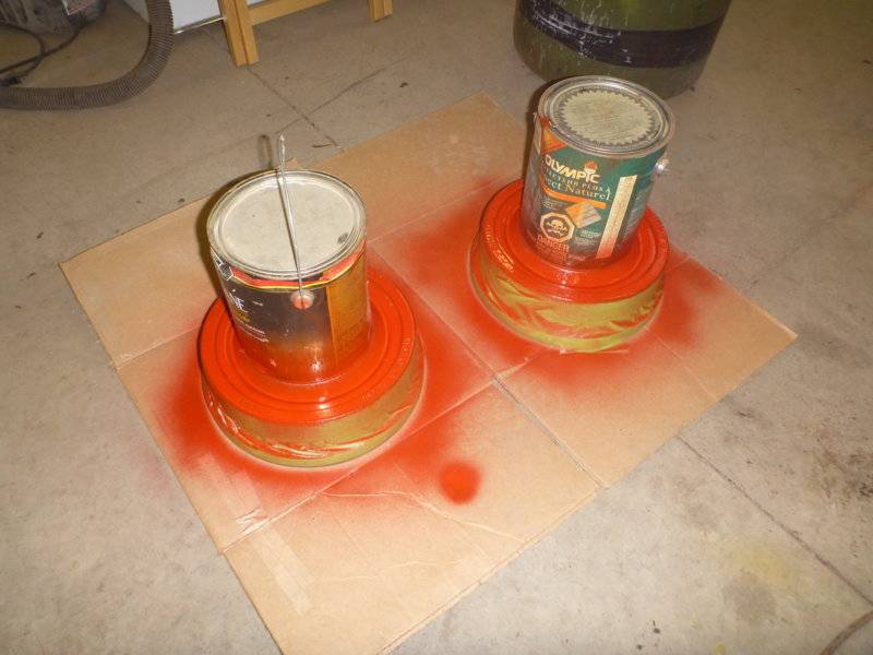

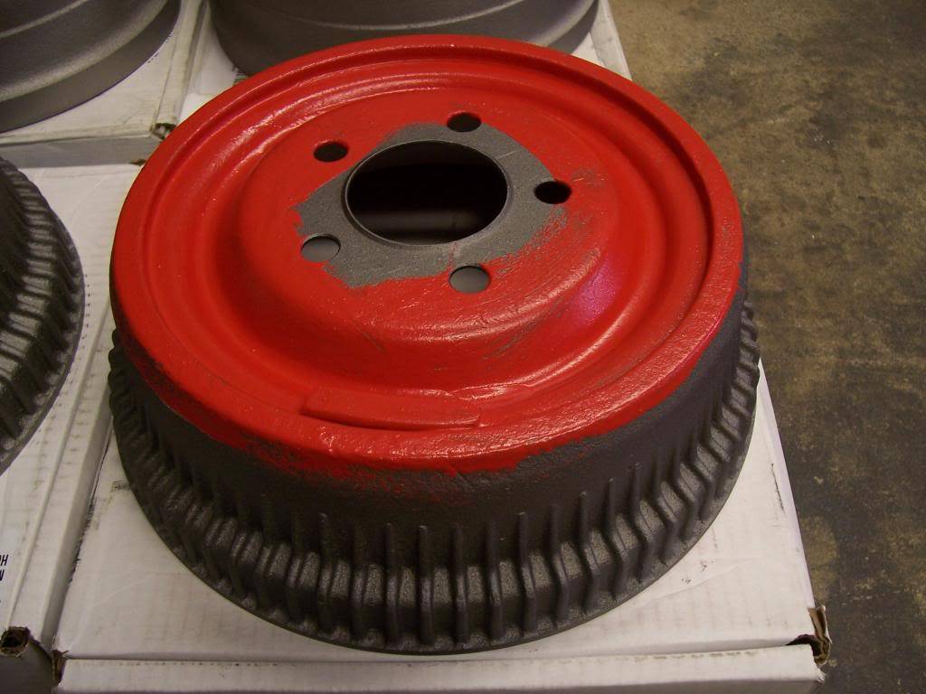

View attachment 805483 View attachment 805484

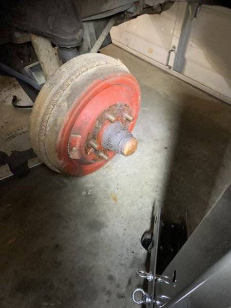

I came across this thread and would like to add a pic I took off my unrestored MN Gold car. 1967 Dodge Coronet 500 4BBL Convertable
Car sat since '79. This is for certain what these drums look like from factory....
