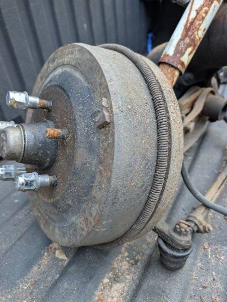

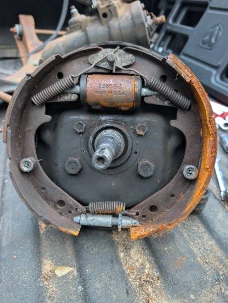

All, I bought another 70 K-Frame & suspension. Why - well honestly it's a bit of addiction :)
I spotted it online from a 70 Charger Big Block. I noticed the drums looked in decent shape and it still had the anti-vibration springs. I thought they'd be nice to have and a few spare parts and sell what I don't want to keep. Good plan right?
Well I checked out the drums and they seem to have life left and the groove for the vibration spring are rust free, so I bought it.
This morning while disassembling I noticed they seemed different than mine. Well duh - they're 11" drums.
So before I go and list them in the marketplace, is there any reason I should consider replacing my 10" front drums with them? My car goal is to put it back to original condition with factory/period parts where possible. Not a concours restore as those folks are on another level. I don't have a build sheet, but I think 11s on front and 10 on rears would be a giveaway. I also suspect the brake system is designed for 10s all around, but I'm not an expert.
Thoughts or arguments to use the 11s? Do people seek them out.

I’m doing the same thing running factory on my 69 charger. They are both 11” and no ware turned and powdered. I’m going this route first then if not liking it I’ll upgrade .
