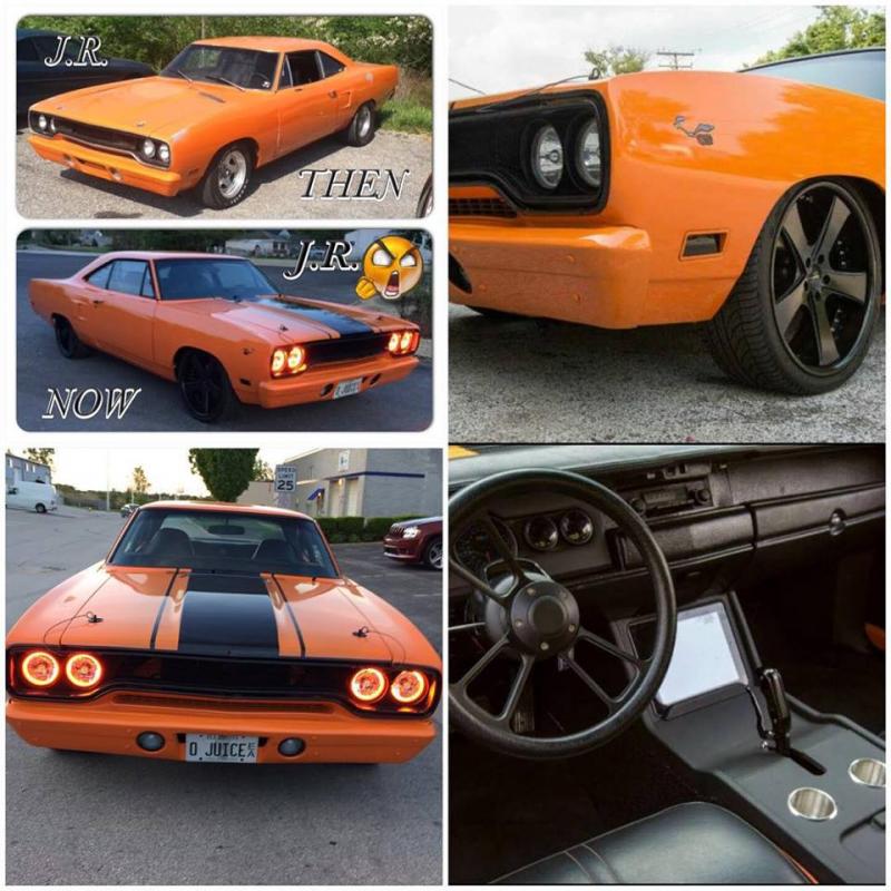

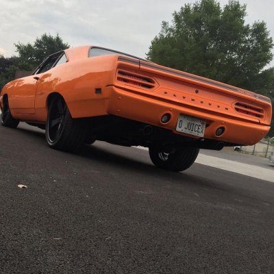

I have a 70 RR and i have22x10 inch BZO rims with 285/35/22 lionheart tires on the back and 245/35/20 on the front. the lip on the rear 1/4's were rolled when I bought the car so that made it easier to fit. some air shocks in the back and i'm rolling!!
cthalite3. That's the look I want. I have a standard factory setup with my GTX. Will I have any rubbing issues if I will go with your setup?
you mite if your lip isn't rolled. I was told the biggest u can go in back is 20 inch rim on stock setup but that might have been an old post. if you do have to make any modifications it will be minimal. I had a guy with 15 years of rim and tire experience measure mine and he nailed it the first time. If you were close to chicago i'd let u test fit one of mine.
