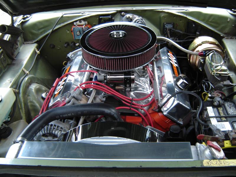

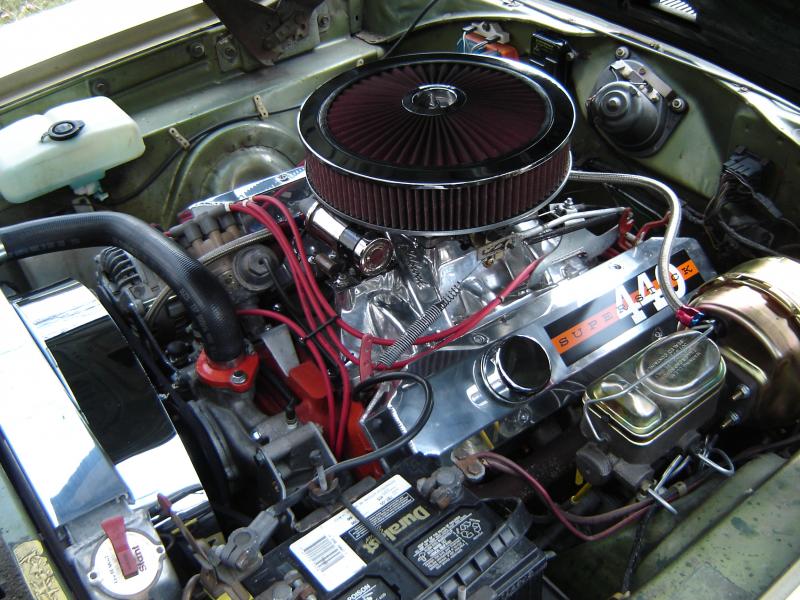

No rubbing issues with mine, I do have a drop down base which cuts down on side breathing, but since the Air cleaner breathes from the top and sides I am not concerned with it. See pics.

With a Mopar unsilenced air cleaner (you can get either chrome or wrinkle black), I had no problem at all.

The Carb. is an Edelbrock 1013 800CFM and the drop base is a standard Holley or Edelbrock one, I do not remember now. I think it drops it down 1 1/2 to 2 inches.

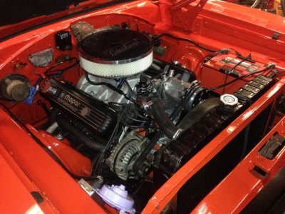

Fits by JUST a hair
This combo fits by just a hair. The air cleaner lid actually rubs on the hood insulation (the stock black foamy pad thing inside the hood. Stock 70RR hood. It's an Edlebrock Performer RPM intake manifold and an Edlebrock air cleaner (that I bought at Pep Boys because the stock twin snorkel definitely did not fit and I just HAD to drive the car with the new engine in it)! It's a Quick Fuel Q850 carb, but since it's holley-based I think it's the same height as other carbs...
