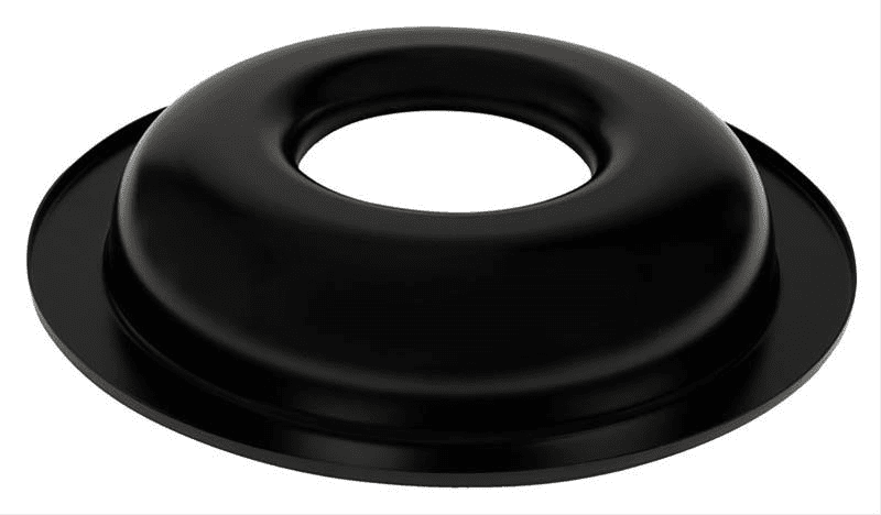

Something like this, in general.
Kframes are the same, 440s are 440s, unless you have some custom homemade mounts, it's all the same as everyone else.

Something like this, in general.View attachment 1884567
As an FYI, this style of drop base pretty much fits Holley's with center feed bowls only. To use it on AFB's, TQ's and some others, it needs to be spaced up almost an inch. There is a drop base unit, can't remember who makes it, that will fit just about anything. It looks like it was formed over a huge Bagel.

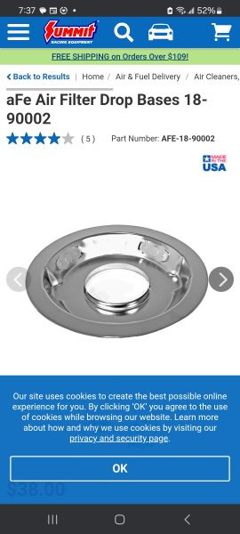

I have an Edelbrook Carb on there now, which might just end up staying. Not a carb fan, I like the aftermarket fuel injection systems out there now. Have used a couple over the years but not sure if I want to spend that much money again switching it over. Is this the base you were talking about? This would be a 1 1/2 inch drop.
:thumbsup: good call, when I think of muscle car carbs I go straight to holleys.
Drop bases are fine but as mentioned you have to watch for fuel inlet and trans linkage room.

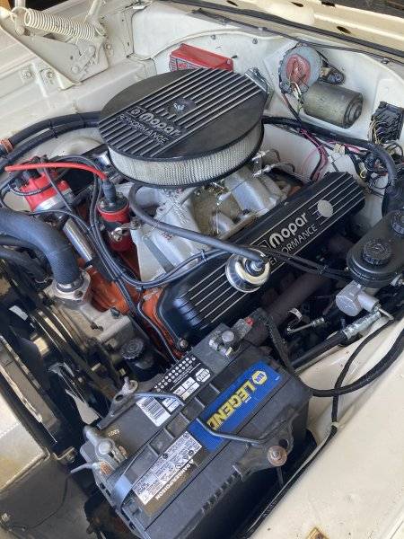

The 2191 Performer is .5”-.6” taller than factory iron, 1” shorter than the RPM.
Yup, thats the style of base you need for the AFB, T/Q, AVS and some others. Pretty much fits them all with the 5.125" opening. From there, watch the filter element height. On that MP unit on my car, it's not 14" diameter. 13 and change. I believe, will have to verify, that I'm using a WIX 42044 element. A little less than 3" tall.
