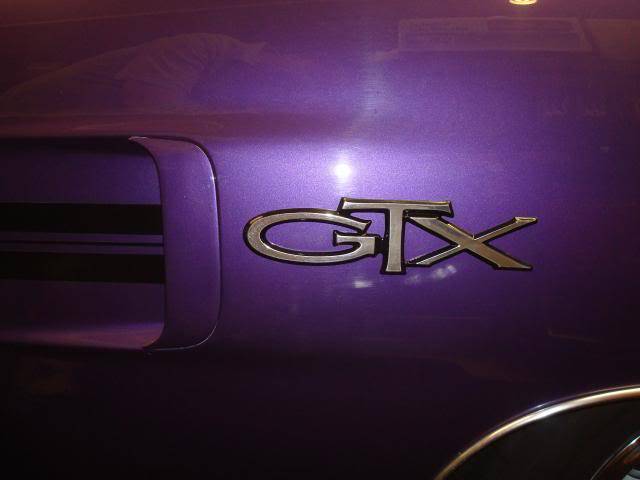

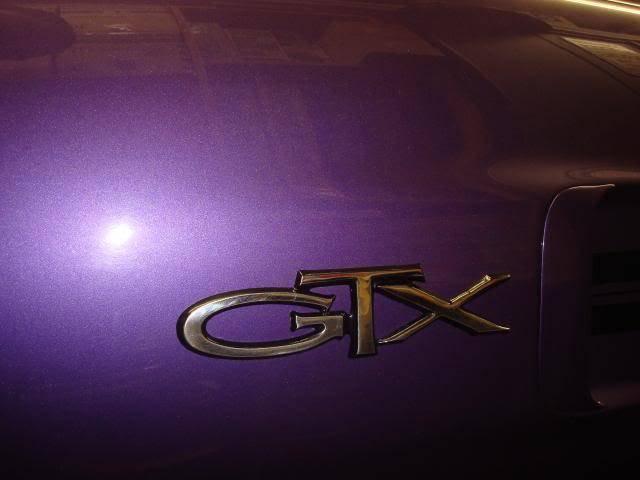

Couple of pics to get you started....
Located on factory made holes.

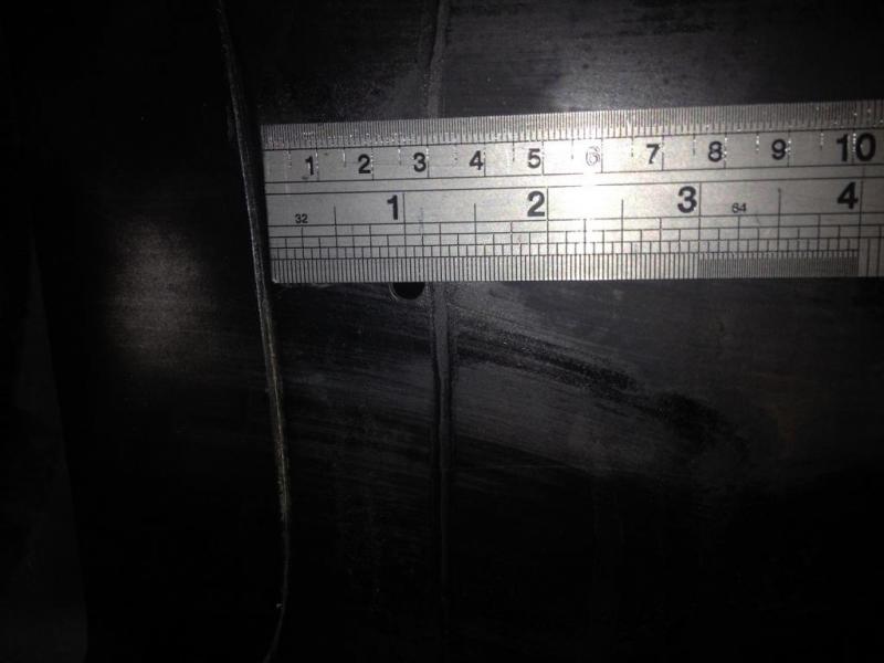

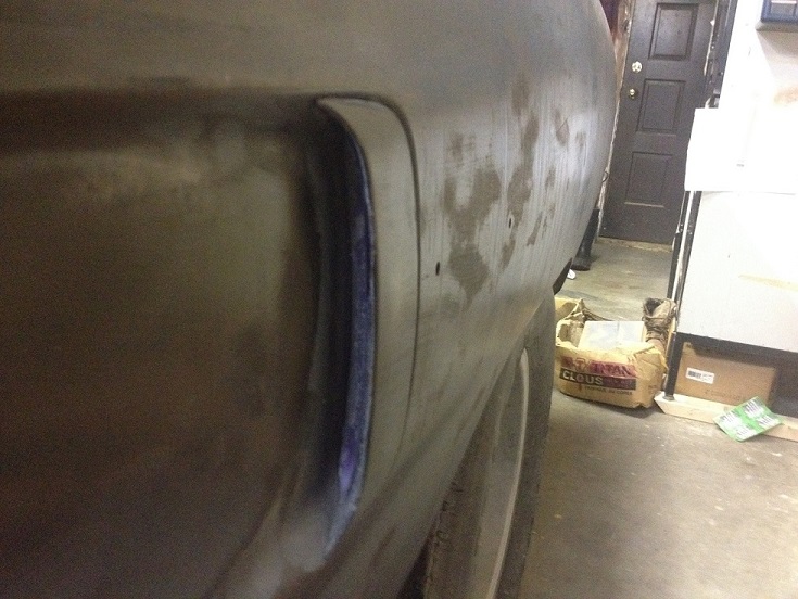

Original, unmolested quarter. An even 3" from quarter panel scoop (not the scoop insert) to the center of the hole and what seems to be the vertical dead center of the scoop. The second hole should be easy to measure if you have the emblem, just ensure that the emblem is level. Picture is off the right side (obviously). Hope this helps:

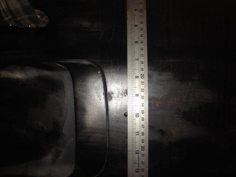

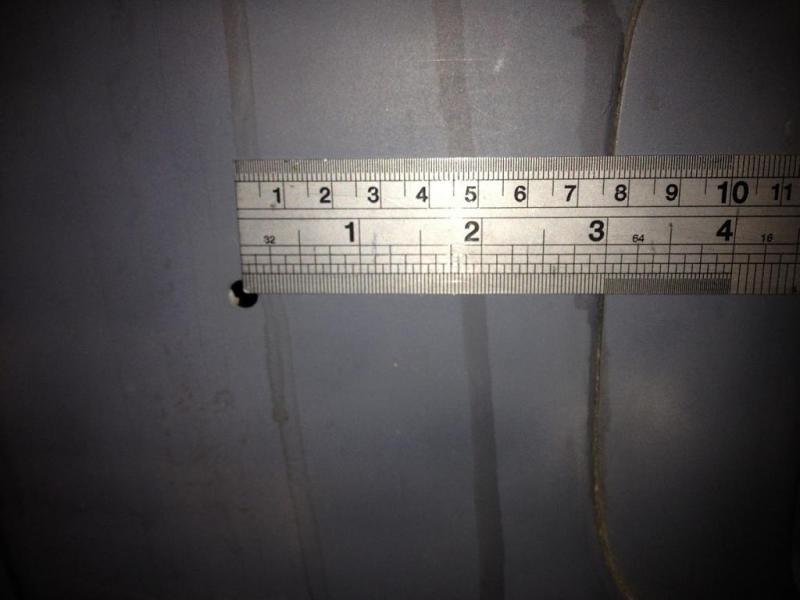

Alright, here it is. The hole measures approximately 1-1/8" from the side of the scoop. The hole does not appear to be aligned with the center of the scoop so I attempted to measure it with a thin metal ruler forced as best I could into the contours of the panel. The distance I measured is 10". I hope that you can make use of these numbers.
