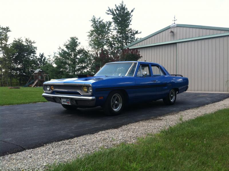

Hello all, I'm getting ready to apply the side stripes on my Gtx wannabe and I was wondering how everyone went about locating them on the car. I was thinking of taking a measurement from the front wheel arch on the stripe and marking the fender, then find the centerline of the scoop and connecting the two with masking tape until it looks level, then use little pieces of that tape for reference when the stripe gies on. Any suggestions/measurements are welcome, thanks!!!View attachment 267639
So I can't really help you with GTX stripes, but I want to pass along one observation for 1970 Road Runners that often is done wrong (it MAY be applicable for GTX cars).
The dust trail that starts at the side scoop does not come out of the center of the scoop. It is supposed to start centered on the Road Runner logo, which is about 2/3 of the way up. When people mistakenly start it in the center, it has to run up hill to clear the front fender. I am not sure if original GTX cars had a similar arrangement, but you may want to check some file photos of original cars to check it out.
When you mock it up, make sure the stripe does not run up hill. With your custom scoops, they may not be a good starting reference anyway, so let your eye be the judge.
Again, I know the above is not GTX specific, but perhaps gives you something to research and verify...
Hope this helps

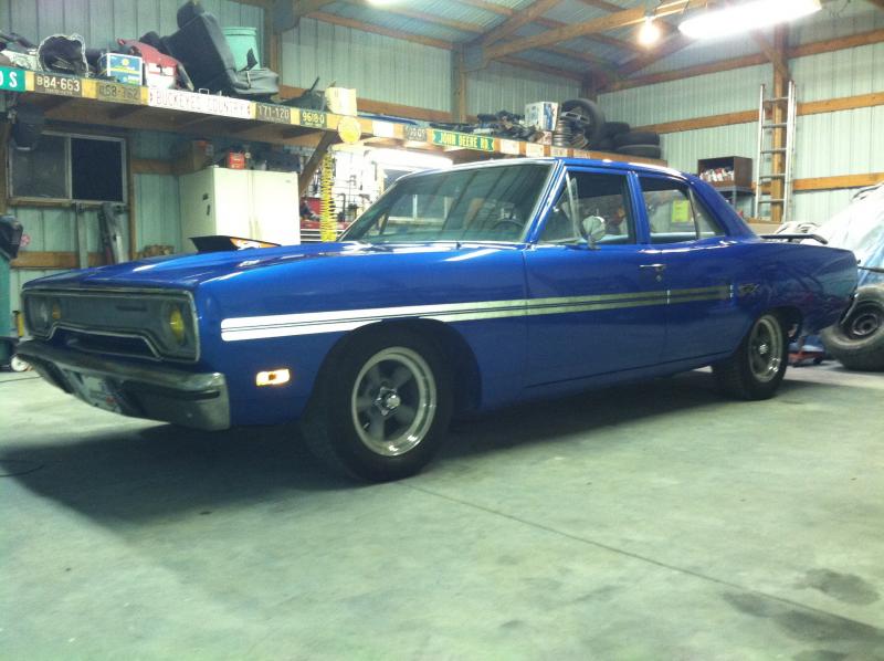

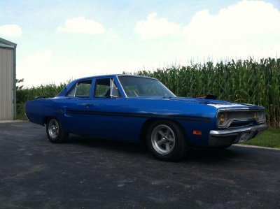

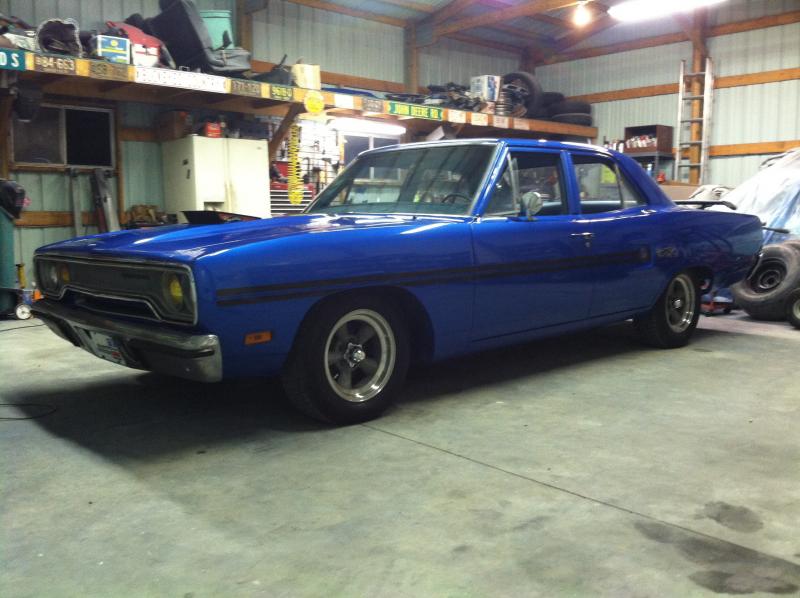

I ended up getting the stripes on, a freind of mine came over and helped me apply them. I mocked them up on the car and marked them with tape, and with the soapy water it was actually easier than I expected. I'm pretty happy, they're pretty straight I think, thanks for the help! image.jpgimage.jpgimage.jpgimage.jpg
