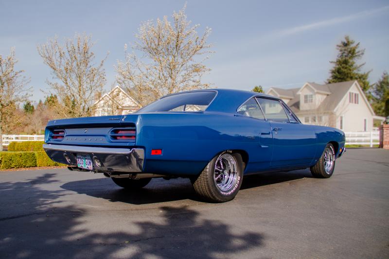

I've been debating back and forth whether to paint my '70 the original B7 blue or Hemi Orange. Seeing your car has made the decision easy. That car is too cool!

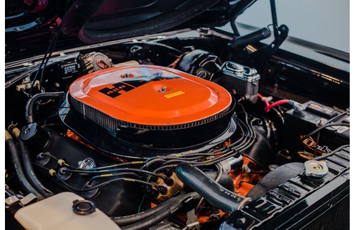

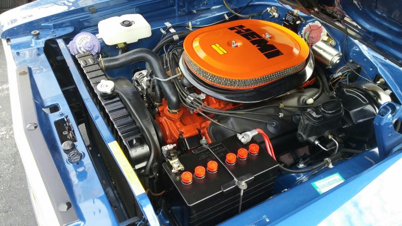

Ok i have a 70 Hemi but it has wrong carbs from a 68 Hemi
The 70 rear carb has an additional vacuum inlet high on the carb next to where the fuel inlet is (& the 68 carb does not have this) which i think goes to the breather on the right valve cover. So the correct breather has 2 inlets one to the carb & the other one goes to the back right side of the bottom black air cleaner housing. is this correct? Also the other vacuum inlet at the bottom rear of the carb goes to the pvc valve on the left side valve cover. Just trying to figure out haw all this works. i am used to working on older cars that dont have all this clean air stuff
thanks All comments are appreciated

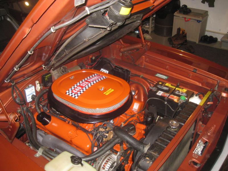

Mine was just a garden variety 383 originally, I'm currently putting together a Hemi for it but progress is slow. 9 months in and no end in sight!
I'm a big fan of original and/or stock appearing mopars like yours. Saving pictures of your engine bay on my desktop for reference.

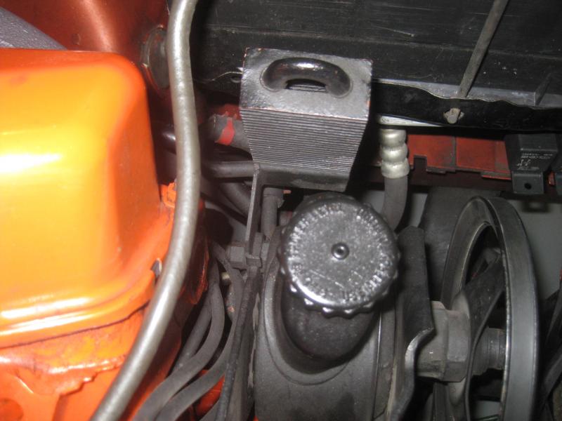

My Hemi RR has its original Federal pump with 3.55 gears has no power steering cooler. My Bird with its original Saginaw pump has a cooler. You are good the way you are. Note the 1970 air cleaner should have no engine call out on a Hemi. only 440+6. In 71 it was swapped. Hemi got the cool sticker and 440+6 got nothing!
So for 1970 the air cleaner only had the little Yellow Sticker with instructions for cleaning filter & Made in Canada ?
Also do you have 70 carbs 4742S & 4745S or 4746S? the reason I ask is looks like you have the same breather that I have on my car with only one inlet. I think the 70 rear carb had a vent next to the fuel inlet that also goes to the breather with 2 or 3 inlets depending on whether it was a California car or not?
Also very nice cars thanks for the great pics
My 1970 Hemicuda is also a single outlet oil breather. I am certain 1971 had the extra nipple and I've seen survivors with and without. I've also seen survivors with three nipple oil breathers. My rule is 1970 is single. 1971 double on a 4BBL and triple on a 6BBL. 72 and up Single. If I used repop 6BBL carbs 1971 carbs I use the double nipple breather.
