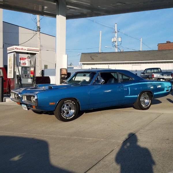

Mopar Joe uses 15x8's with a 255-60/15. I don't know what he uses on the front. 7" standard offset but no clue on tire size.
