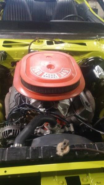

so why is there two different air cleaners for the air grabber-tops?
383-440 B-body 4 bbl fresh air air cleaners:
1969 has oval base, filter and top
1970 has oval base (different than 1969) round air filter and round top.
383 taller neck that sits on carb
440 short neck that sits on carb
My early 69 built 70 model came with a 1969 type oval bottom and top. Saw this same discussion on GYC episode. Some early 70 builds received carry over parts e.g. the aluminum six pack intakes used on 70's before going to cast iron.
