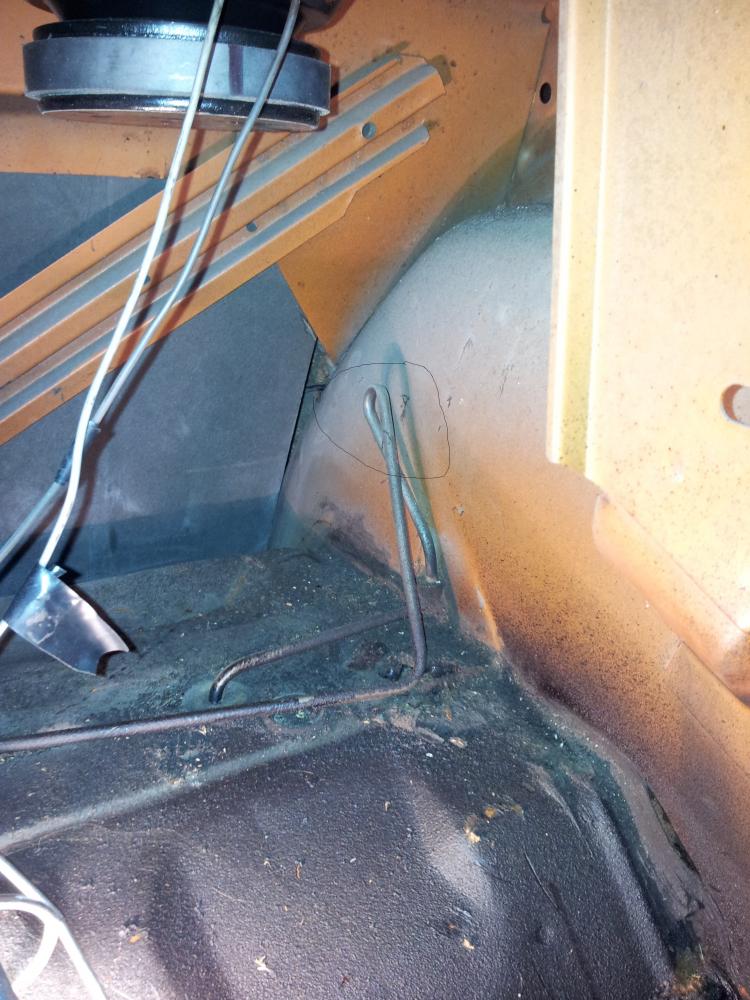

Hi,
can anyone help me to understand what is reported in photo?
is this a fuel line?
is it factory?
thanks and regards

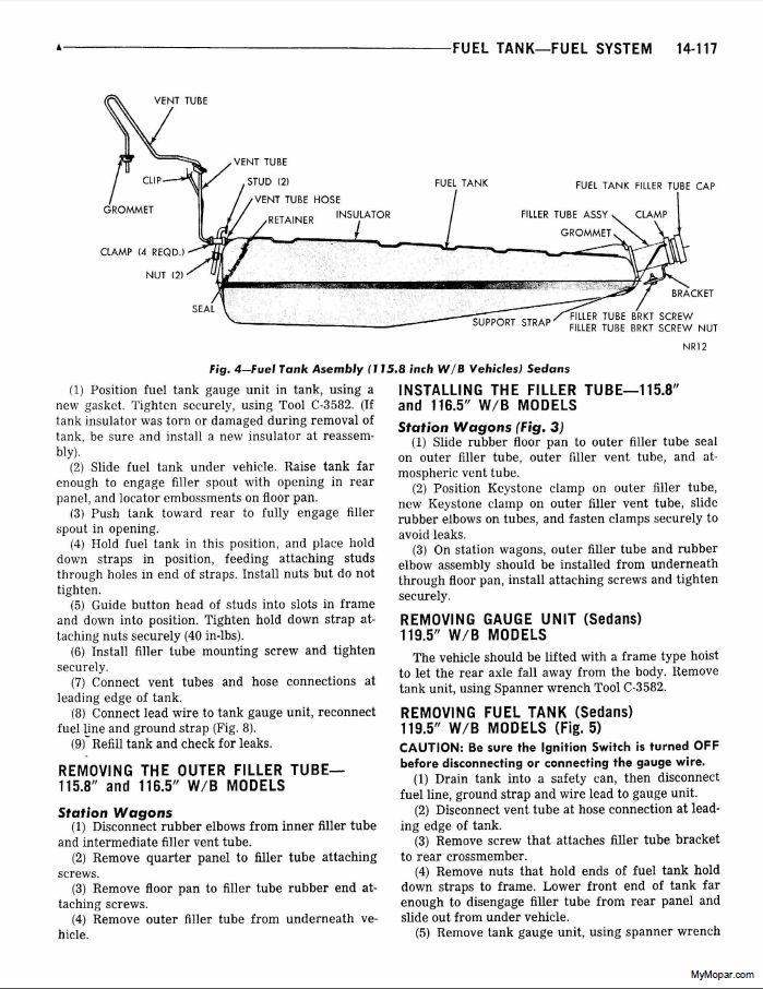

That's the vent for the fuel tank. I'll include a page from the shop manual that shows it:
Photon440,
thanks for your fast response.
so it seems to be factory!
thanks a lot.
