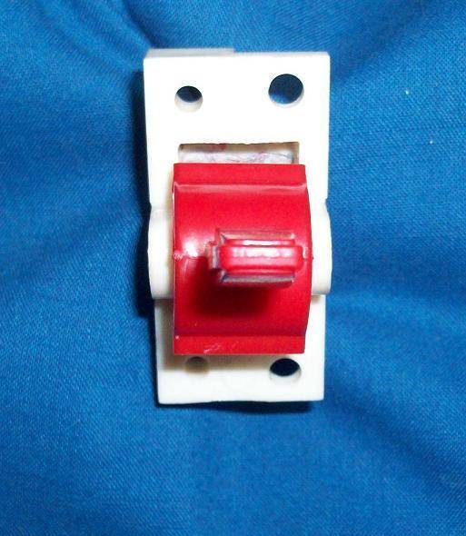

Neither. 70 uses a vacuum operated switch with a red switch. It does have a little "solenoid" that goes with it to hold vacuum for a little while after the key is turned off.

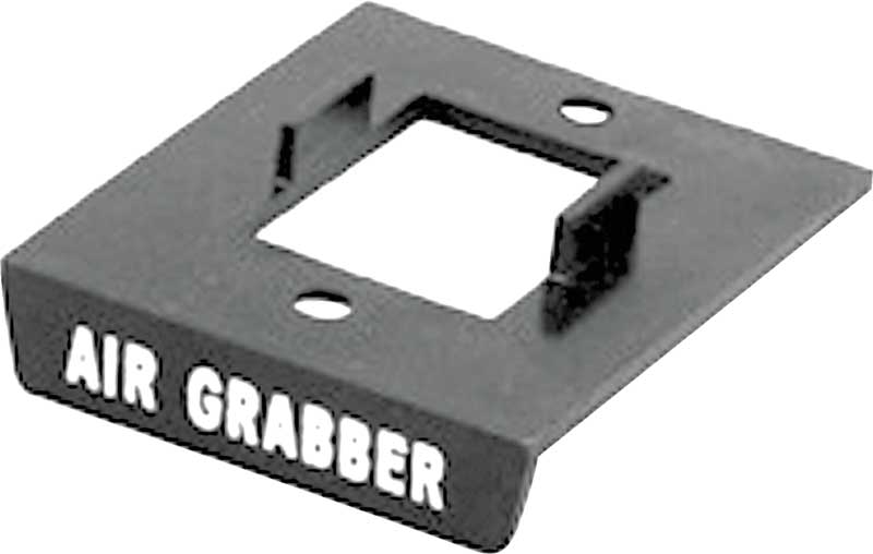

<-- This bezel goes on dash around switch

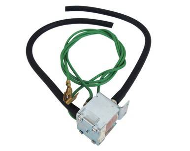

<-- This solenoid goes with switch to hold vacuum

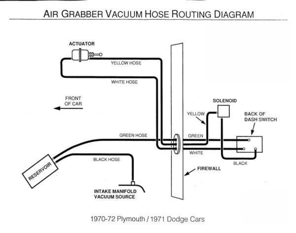

69- cable
70- vacuum
71/72- electric
