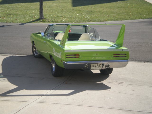

its all bolt on and nothing that cant be changed back . But it will stay this way as long as I live

That car is frickin' beautiful!, no harm, no foul there.:grin:

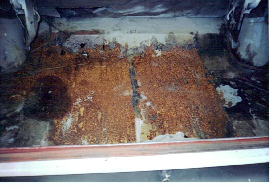

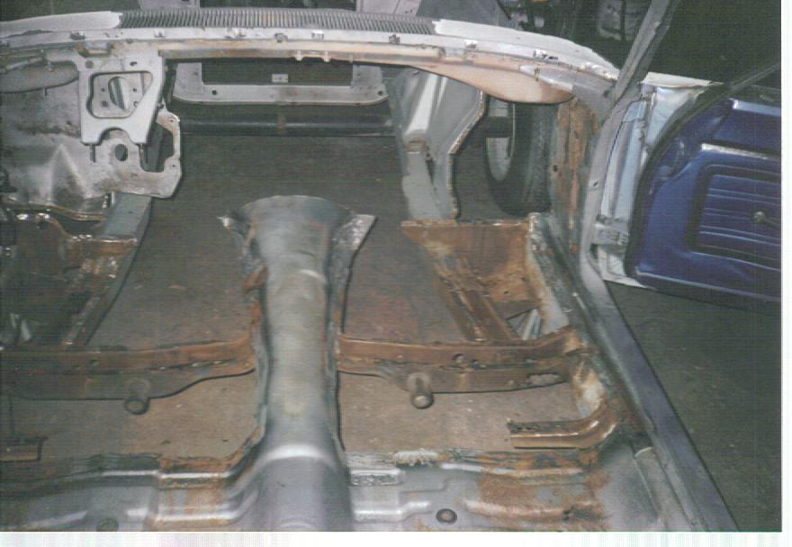

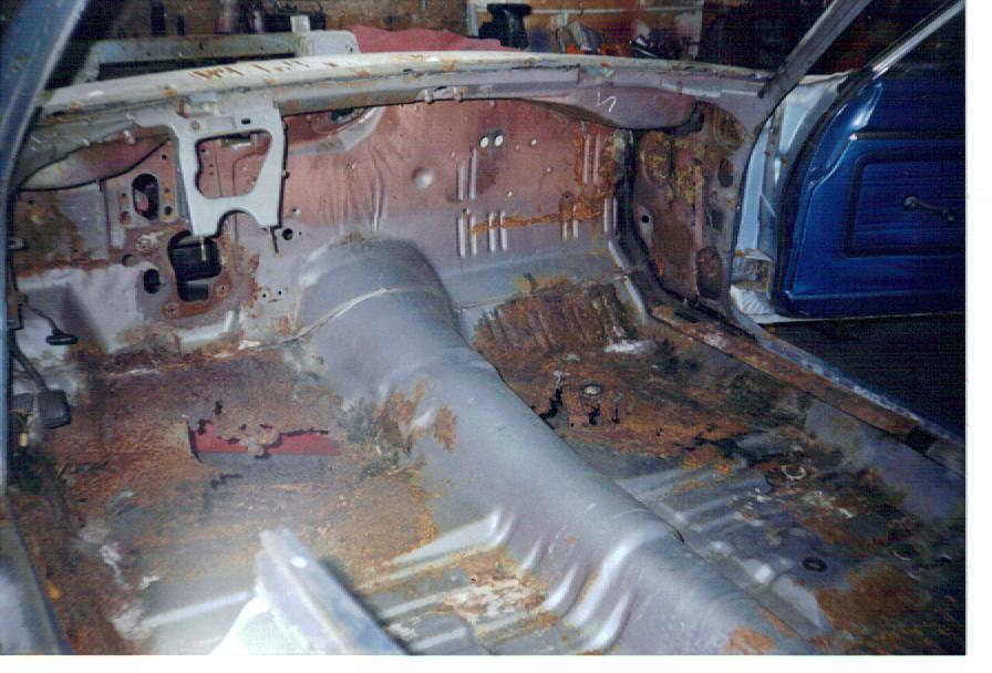

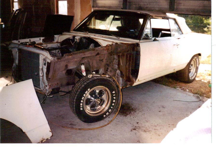

the car came from long island and the sea air had taken its tole
The u shape channel that supports the whole rear upper sheet metal on the rear of a b body convertible was rusted away. No one makes it so we had to fab one up from scratch. The rear panel inner and outer dutchman between the rear window and trunk was swiss cheese too . No ones makes them either just the corners . That was a huge job .
You did good. Nice save! If you hadn't saved it, it likely would have been lost forever. It does look great, and of course its your car, so you build it the way you want. I do hope that some day it will be a Road Runner (or Satellite) convertible again. But in the mean time you do have a beautiful convertible to enjoy. I'm guessing that there are likely no more than a couple hundred 1970 Road Runner convertibles and maybe 150 or so 1970 Satellite convertibles left in existance. I'm guessing many, if not most, of those remaining Satellite convertibles are already Road Runner clones.

Another clue is that the blue interior door panel seen in the photos of the rusty floor, is a blue door panel that was used on the 70 Satellite and Road Runner, but not on the Sport Satellite.
