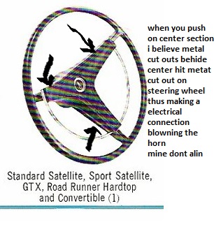

1970 road runner steering wheel to column assembly photos needed
the 3 spoke steering wheel cover ( that includes round runner picture on it) that goes over the steering wheel. something does not seem right. there 3 notches that show metal so when you push the 3 spoke thus will make a connection that engages the horn. The notches don't line up.
am i missing something here. Any guidance would help
Thanks for the help
Jim
I have the same wheel on mine. Did you take it apart?? If so, the mounting plate can be rotated around to the proper position.

Hi Chuck
Which mounting plate are you referring too?
Thanks Jim

I'll check mine & let you know. You need to remove the RR button & horn ring. They attach to a round spring loaded mechanism. Make sure that is mounted correctly. The ground wire attaches inside of that. When you press the horn ring, it grounds it & blows the horn. I'm trying to find a pix of it for you.
Chuck

That's chuck looking forward to see the pictures.
Thanks for all your help
Jim
