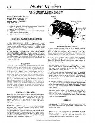

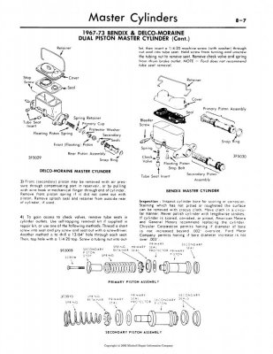

Here is some diagrams for you. Hope this helps.
Thank you. I did get the piston out. After I realized it was stuck I was able to push and release quickly to get it to pop out partially. Used ring pliers that open to grip internal of plunger and pull out. So how about a rebuild kit for this, and sources? It is 1.125" bore. G
