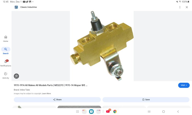

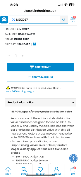

I’m adding a power brake unit to my 68 roadrunner that has front disc brakes. What do I need in the form of a proportioning valve? Classic industries says I need a distribution valve AND A PROPORTIONING VALVE. Where would I mount these two valves if they’re needed?
I'm fairly certain if you have a disk/drum master, all you need in the distribution block.
1967-70 Mopar B-body Distribution Block, Disc or Drum
If your car had drums originally, then all you need is a proportioning valve in the line to the rear brakes
What I’m looking for is IF my car ALREADY HAS the stock proportioning valve, is all I need to do is to ADD the distribution valve?
This is a distribution block/pressure differential valve, Your car should already have one.
