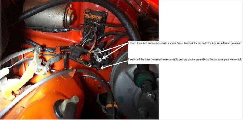

OK, so my 70 road runner won't crank using the key. Sometimes it would when I shift the gears back and forth from park to neutral (automatic transmission) but now it only works once in a blue moon. I tried by-passing the neutral safety switch, but that doesn't seem to be the problem. I can turn the key on and start it by touching the two points on the starter relay switch in the engine bay. Do you think it could be the ignition lock cylinder on the steering column needs to be replaced or the actual starter switch in the column? Or could it be something else? Thanks in advance.

Which two points are you jumping at the relay?
Because it could be the relay.

This is how I crank it using the starter relay switch:

Close but red to yellow would pull in the relay you are going battery to starter Bendix. Try red to yellow and see if anything happens. If not you need a new starter relay
I don't know what your talking about. When I touch those two points on the starter relay I show in the picture, it cranks the car and it starts (just as if I'm turning the key).
I'll try again.
You are not using the relay to energize the starter you are bypassing it.
Put 12volts on the terminal where the yellow wire connects as that is the terminal the ignition switch powers. If it starts you have an ignition problem. If not you need a new relay.

Thanks for all the help. I changed the starter relay switch and that was the problem (not sure if the old one was the original). Cranks like a charm now! :)
