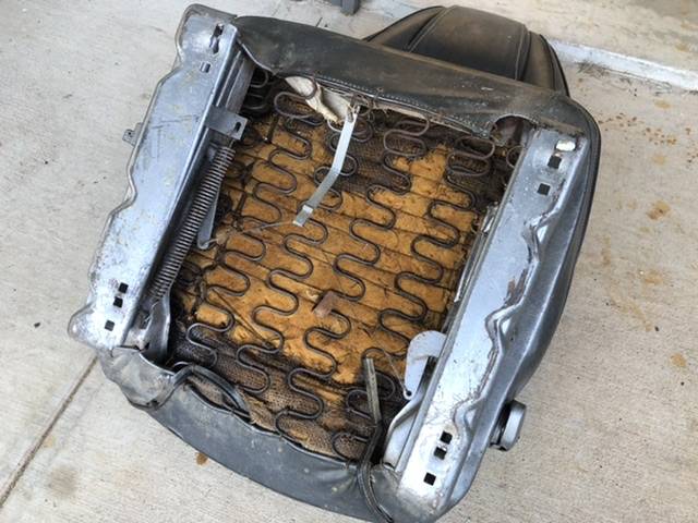

hi, does anyone have close up pictures of 1970 roadrunner bucket seat track pictures. i may be purchasing a pair of buckets and want to make sure they have the correct seat tracks. thank you!
Best I can do with pics on my phone. These are '70 Charger, which are the same. I’m installing new mount studs in this pic.
One more thing to look for is 1970 to early 1971 buckets had a different seat release and seat back. The buttons were metal vs the later ones that were plastic.
Also 1970 didn't offer black, instead it was charcoal. As you can see in my pic, the vinyl has been recovered in black, but the tracks are still the original charcoal.
