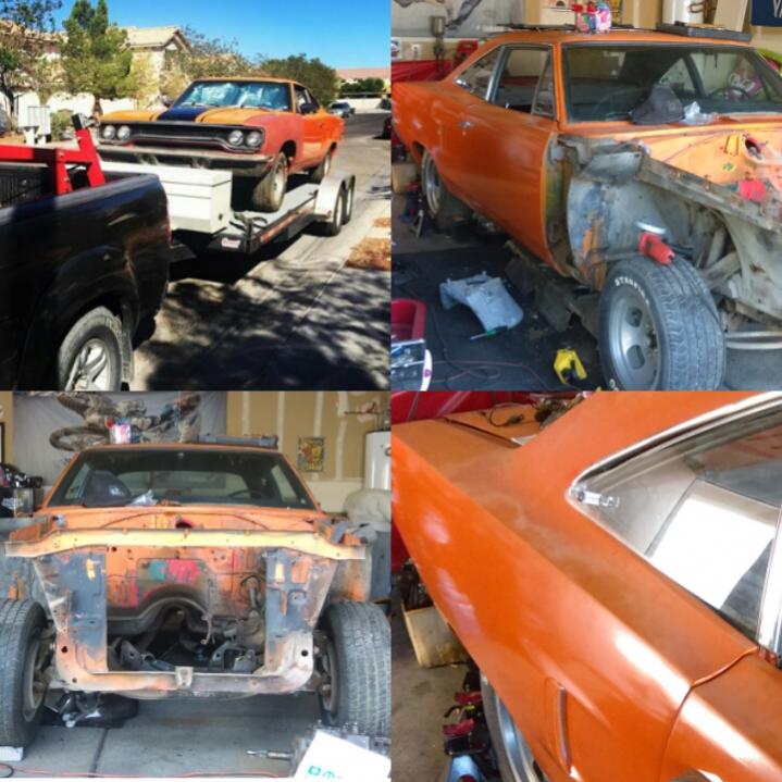

Hi everyone, new to this forum, and prolly will have some questions along the way restoring my Roadrunner. This is a garage build father and son. single father grew me up in a bodyshop my whole life. Just found out My father was just diagnosed with a brain tumor, and God forbid anything to happen, but we agreed to do this one as possibly the last one we do together. I really am in shock, We mostly know chevys. New to mopar, (Also bought a 66 Nova recently )
About the Roadrunner, we purchased the car for a old man in Utah
(Im currently in Las Vegas) it's a 4-speed Car with the 833 trans and a non numbers matching 383. The previous owner pulled the motor back in 2001 and had it overhauled. 20 over and the whole 9 yards, Receipts on everything. I started by stripping the bay down with aircraft paint stripper and a wire wheel. In the process of getting the bay prepped for POR-15. QUESTION: I know Por 15 Is a good product but never did a bay with it. Any complaints? And when it comes to the motor, that's been sitting I beileive 14 years, sujest taken the heads back off?

Thank you for the input, that's what I was pondering as well I'll do the suspension parts and floor pans, but the bay I'll prolly paint. I'll post some pics soon, what's a good degreaser, I'm reading oven cleaner in great to use?

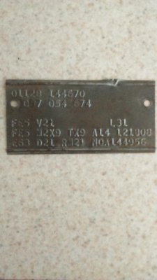

Maybe someone can help me decode the fender tag, I decoded the vin already it's a RM21 (coupe) car built in Detroit
Working on stripping the bay down with paint stripper and a wire wheel like I said. Cars been painted 3 times original red green then orange

Good luck to your Dad, hope he makes it. 70 RR is my alltime favorite car. Have not owned one lately. Just Google fender tag decode.

So far as the fender tag just google "fender tag decode" and similar, you'll find sites. SOME of that is in the front pages of the shop manual
