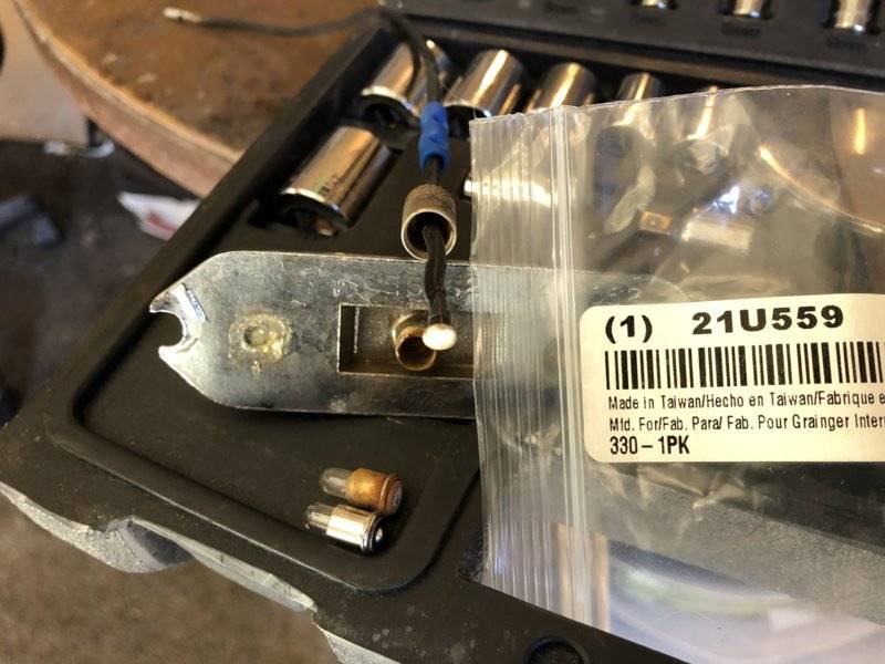

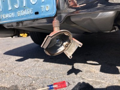

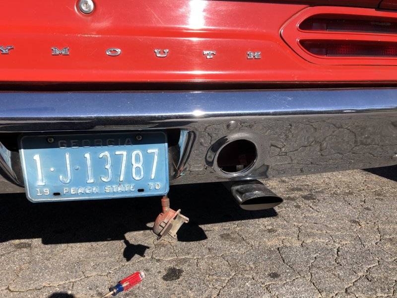

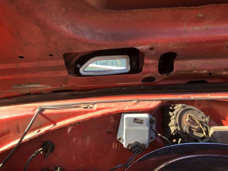

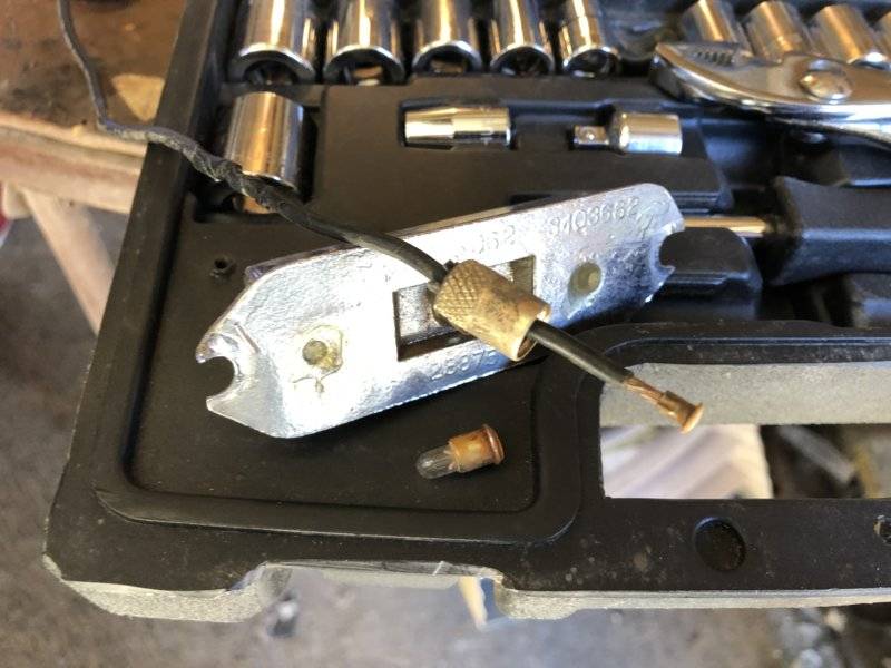

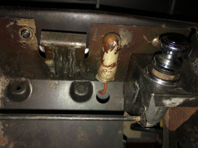

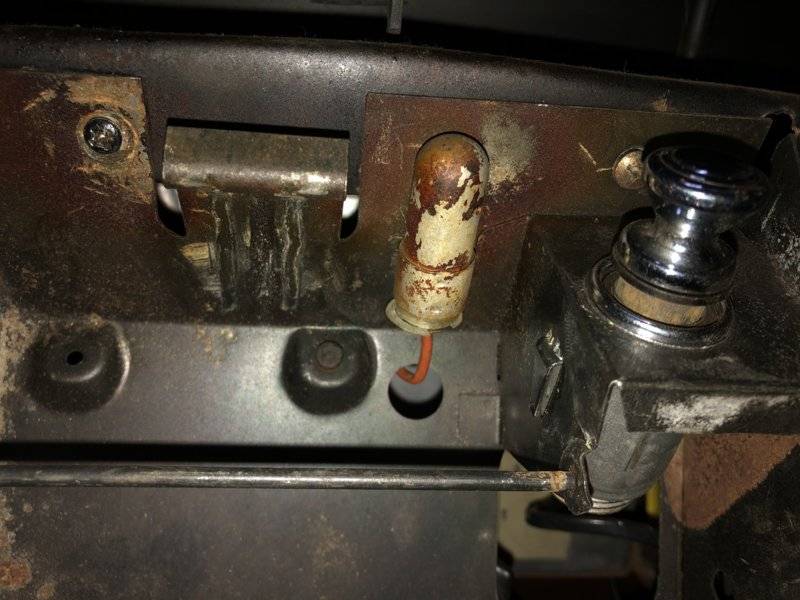

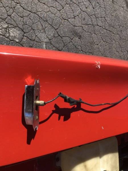

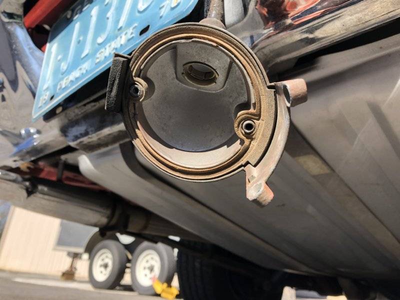

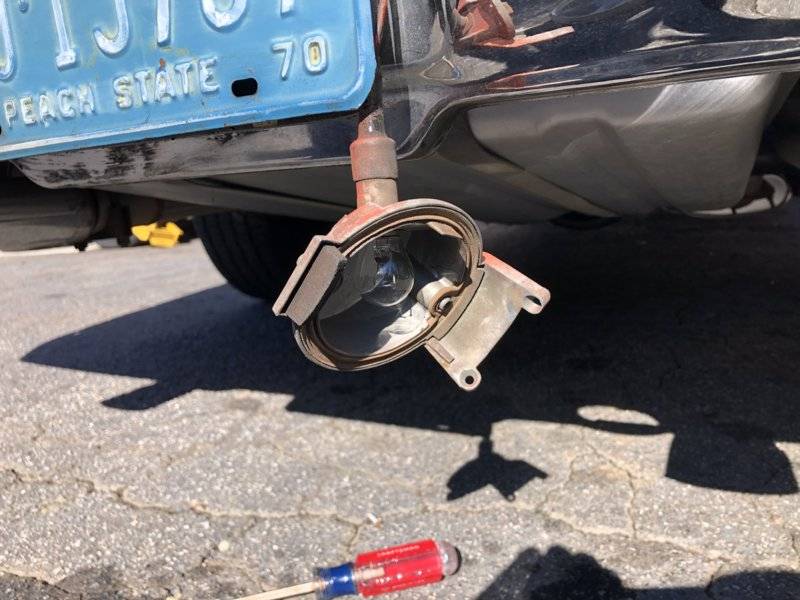

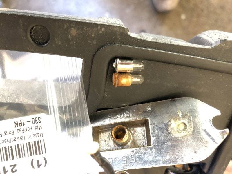

I have been working on lights on John's roadrunner. Got the hood turn signals working, cleaning the contacts, installing new Y330 bulbs and connecting the wires. Now I have replaced the backup light bulbs but they are not working. I need to check the backup switch is connected and working on the transmission, it was a automatic column shift car before the 4 speed installation. Replaced the map light and it works but the switch is broken, any recommendations on switch replacement. In the ash tray there is a cig lighter and another electrical piece, up by the top, but it doesn't look like a light bulb, what is it?

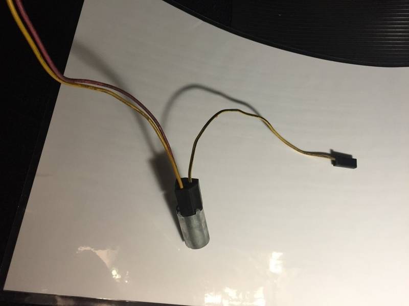

Does it look like this? If so thats the time delay for the lights.
Its a timer to delay the lights when you turn off the lights. Illuminates for a few seconds later.

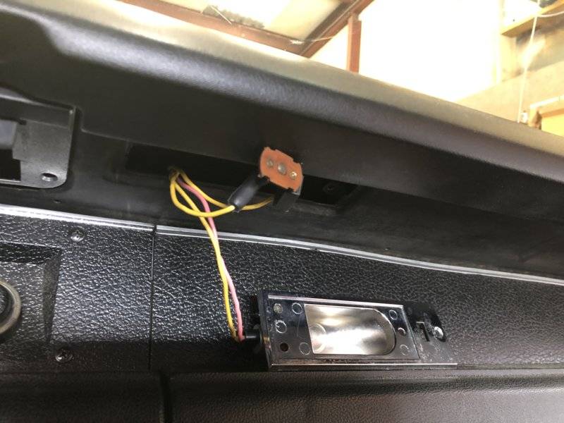

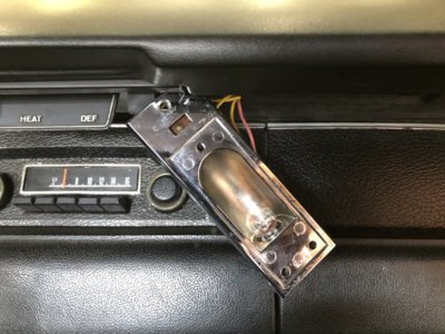

I got all the lights working, hood turn signals, reverse lights, dome light and map light. The dome light was a 90 bulb, not a 2112. The map light bulb works but the switch has missing parts. I was able to snap the small PCB into the light bulb housing, but I'm missing the plastic switch maybe with metal contact on the back?

DWoody stated, "In the ash tray there is a cig lighter and another electrical piece, up by the top, but it doesn't look like a light bulb, what is it?"
If this piece is a small silver cylinder with 2 small holes in the side and has a rounded end and has a single orange wire pigtail with a male bullet connector end and a small clip that holds it to the top of the ash tray.....then, it has a bulb inside with a blue plastic inner liner and serves to illuminate the ash tray when lights are on.
The pigtail will plug into the triple female bullet receiver (orange).

Thanks, I didn't go back and look at it till now. It is a light, I was able to get the bulb out.
