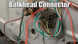

So yesterday opened the driver's door and console light and dome light went off and thought I hear a pop. Now no power to the car inside. No power at starter switch. Everything under hood shows power. Even checked the blue fusible link on bulkhead connector shows power their but have not checked inside the car yet. Replaced the start run solenoid under hood. 69 Plymouth roadrunner with 383 four speeds. Any thoughts would be appreciated. Blue. Oh no fuses blown on fuse block in glove box.
check your bulkhead out, pull and inspect the plug and wires.
Nothing looks burned there. Used contact cleaner on all connections at the bulkhead connector. Reading voltage on the blue wire at the plug end of wire harness. Contact block looks good also. Scratching my head trying to figure it out. I guess back to the drawing board. Will run an AMP draw on my battery with my tester. The pop sound is what I am concerned about not a good sound being a retired electrician. Thanks for the input davek.
Check your voltage at both terminals on the ammeter. If you have voltage going in but none coming out, there’s your culprit…
