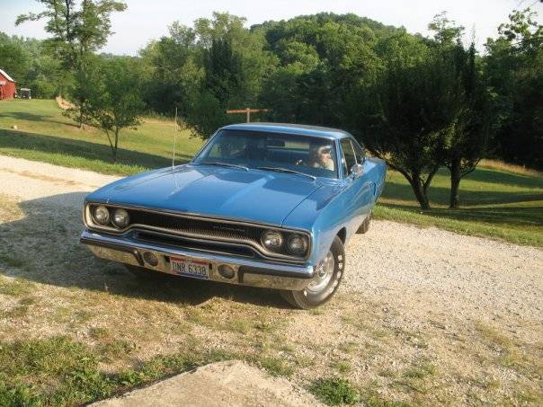

What is the best source/ rebuild to upgrade the original a/c compressor to use the modern refrigerant? Thanks
