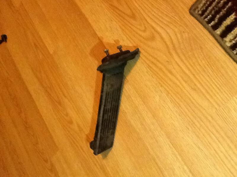

Hi to all,
can anyone tell me how to remove the accellarator pad of my 70 RR?
Thanks a lot
Roddy

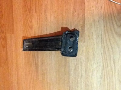

They have two studs that extend through the floor and are fixed with nuts. Look under the car in the aproximate area where the petal is.
Here is a couple of pics of a removed accelerator pedal from my 70 RR that show the studs and bolts that 68chicken is talking about just in case you need some visual help.
