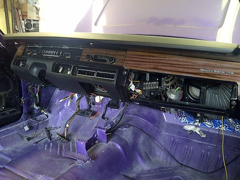

Hey guys. I am finishing my paint and am planning to start assembly. My dash is completely out (see picture). I am trying to figure out assembly sequencing and should I go aftermarket or stock hvac. I have all the original ac equipment.
Can I install an aftermarket set up with the dash back in? What about ductwork etc? Which system have you guys used and how difficult was it to put in? Roughly what was the cost in doing it?
Was also thinking about rebuilding the original hvac system and doing in two parts. The first the interior system before the dash then later down the road hooking it and installing the remaining system in the engine bay when time and money permits. Would that approach make sense?
Any recommendations and advice is appreciated!

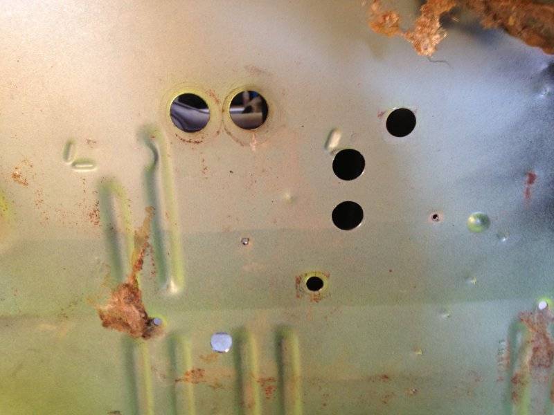

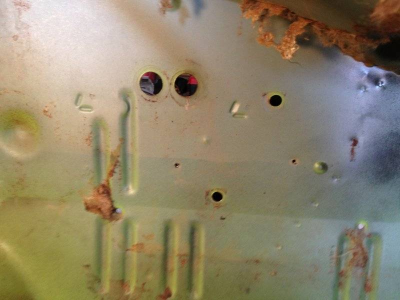

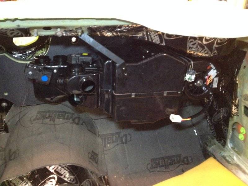

Here are some pics. First, here is the stock, non-A/C firewall.
Here is the same firewall after I drilled the holes needed for the A/C system.

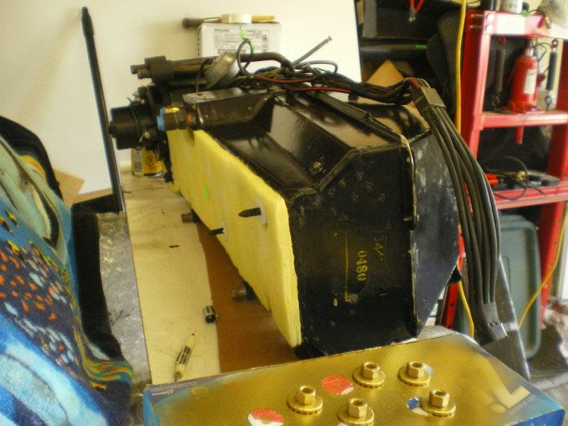

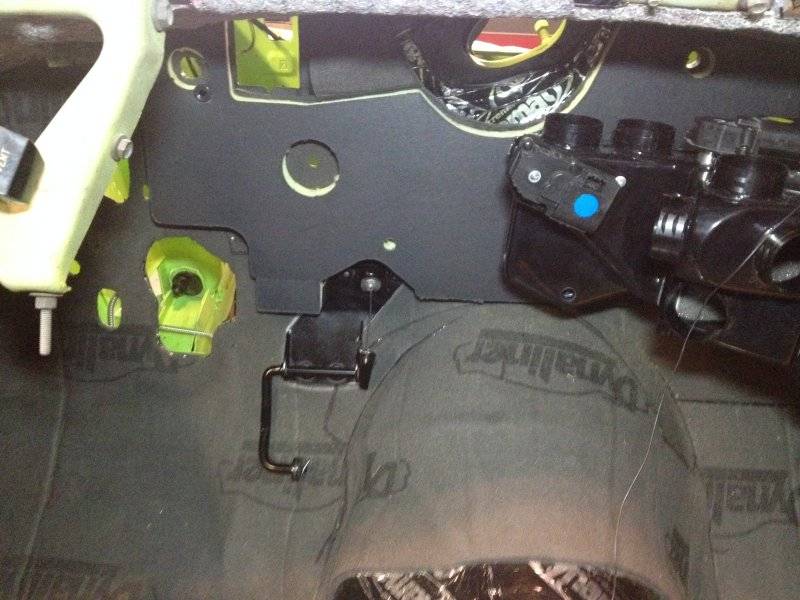

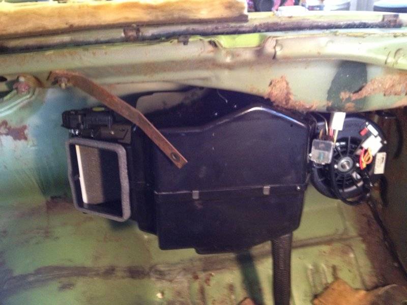

Here is the heater box mocked up in the car prior to restoration, and then later as I was putting the car together. (Note hammer handle holding it up in the first image!)

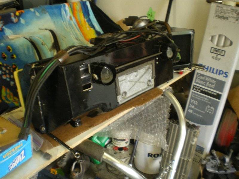

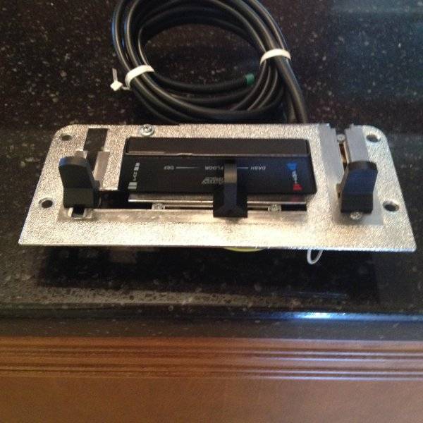

Classic Air provided an all new plate with the controls, but it was a black painted metal piece. I didn't like that, so I adapted the new A/C controls into an original plate.

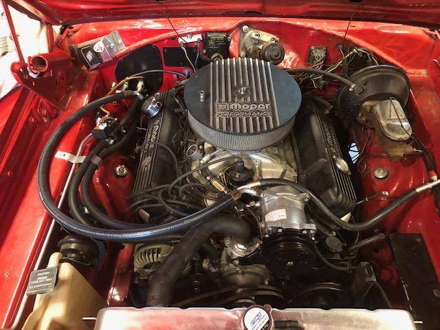

My A/C compressor is not standard, it is hidden below the alternator where the fuel pump would normally sit, so the plumbing for that was fully customized.

Hey thanks Hawk! Did that fire wall insulation pad come with the kit? Did you use that as a template to drill the holes on the firewall?
No and No. The firewall insulation was a separate kit. I can't remember where I got it from, but it was a large kit with all the insulation needed for the car.

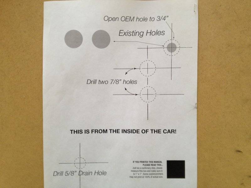

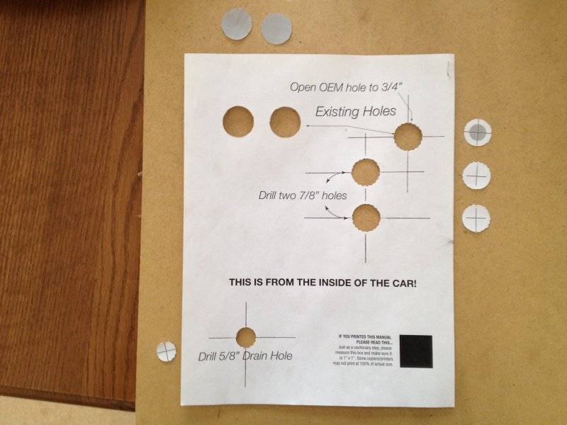

The Classic Air kit came with a paper template for drilling holes. You can actually go to their web site and download the template if you want to compare it to your actual firewall.
I would trust that template as far as I would condoms from Harbor Freight. The way to make sure you get it right is to mock up the HVAC unit and mark the firewall to match where the drain exits the HVAC box. Pull the box to drill the hole, install the box for good.

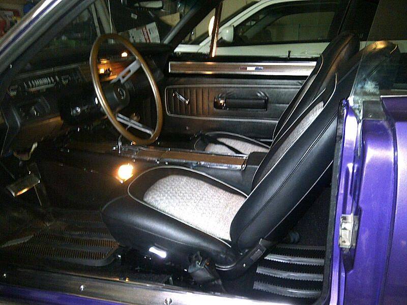

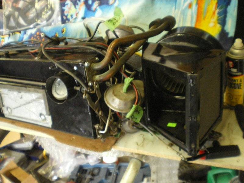

If it helps any . . . when I did my 70 Sport Satellite, I restored the factory AC that it came with, including the RV2 compressor . . . think I have like 50hours in the under dash unit . . . at any rate, it is ice cold. System charged with R134a . . . got the hoses, and evaporator & heater core from Classic Air . . . only had to get it recharged once, in the 12 years since I have done it. It is a true FC7, AC, console, buckets (6way manual drivers), cruise ctl, car . . .
