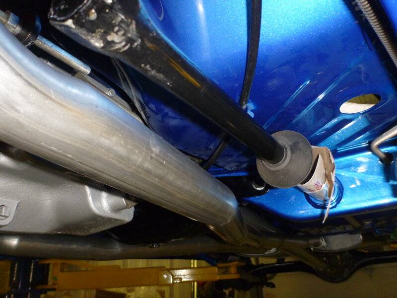

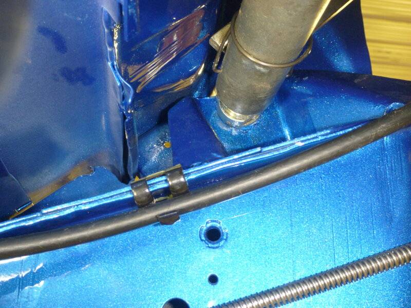

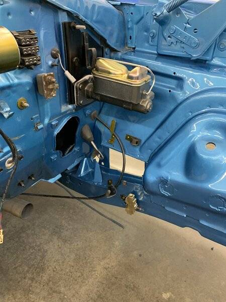

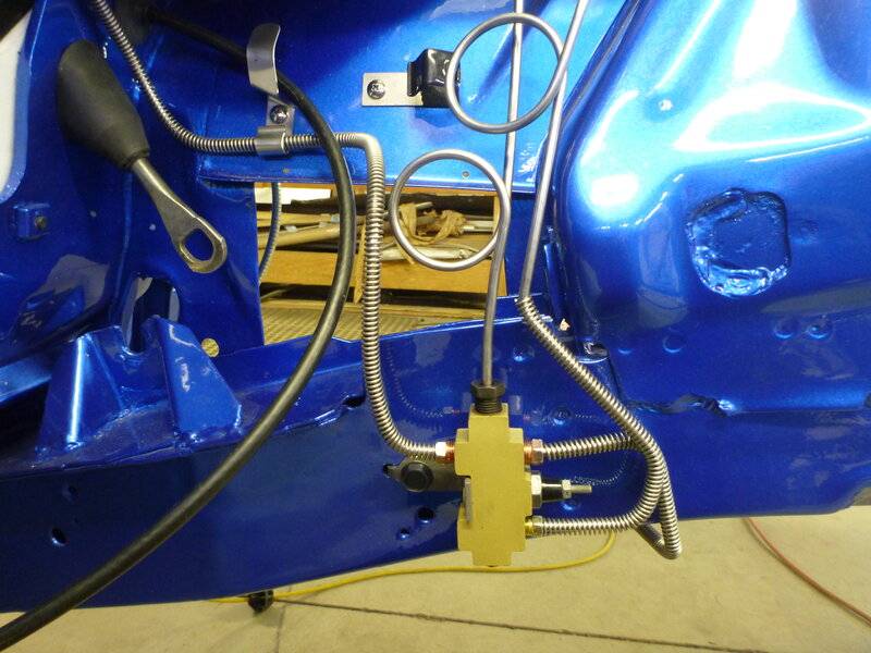

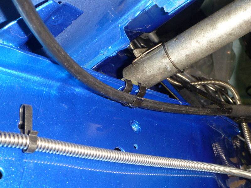

Does anyone know where I can find a diagram that shows how the speedometer cable should route from the back of the dash to the tranny. Verbal description is fine also. I have a 1970 440 GTX 4spd. Thanks

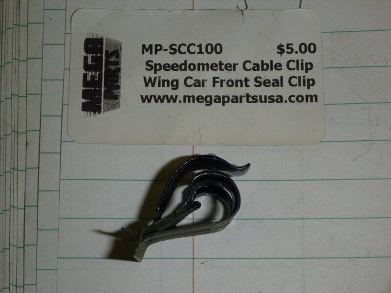

this should help you out some. There’s also a clip spot welded to the floor pan the cable runs through that you can’t see in the pic.
