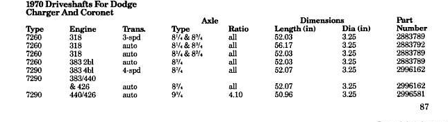

I've have a driveshaft from a 68 GTX 4 speed Dana 60 laying around it's 50 1/2" With 7290 u-joints. Just removed it from my car when I changed it back to an 8.75" rear. Any help?
440 with a 4 speed , w/Dana rear
What is the correct length center to center u joints?
Found this on DodgeCharger.comForum
Got this on another dodge Charger website. 1970 Coronet/Super Bee.
oops thought it didn't post
Is that manual or automatic transmission?
Doesn't matter but all 440 six-pack with manuell came with a Dana 60 from factory, all with 9 3/4 Dana are same, the difference between Dana 60 and a 8 3/4 is 1.14".
