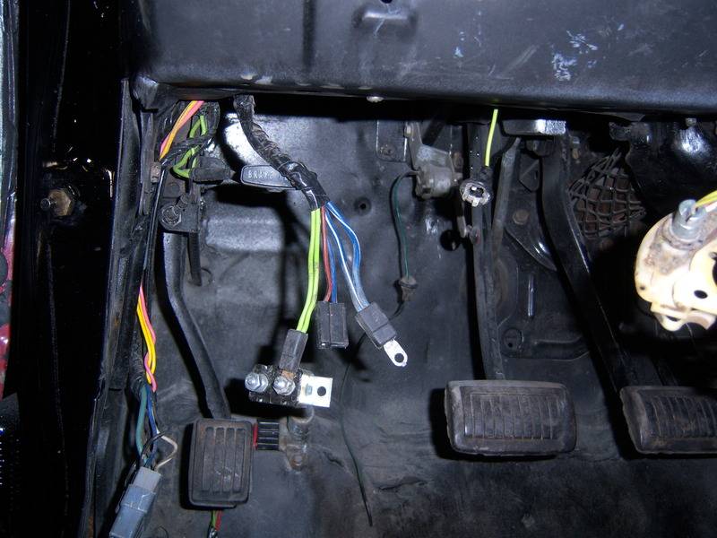

I had to get busy on my road runner 440 6 pack 4 speed, have until the end of the month to move her from the body shop she has been stored. Had a lot of the work done but plenty more to do. I ask the manager of the shop if I could get as much work done on the RR up to June 1st he said no problem. I worked in the shop for many years until a few years ago when I retired due to health reasons. I'll post some before and progress images but my main reason for posting, I am trying to find where a couple dash wire harness wires go or what they are intended to be for. my Service manual doesn't show these wires? both have eyelets and are located on the left side of the steering column, blue with white tracer and light green. the plug in the center of the two is for the flasher. I tried hooking together with a circuit breaker, that isn't right when I did this the head lamps stay on with the head lamp switch off and key in the run position. the car has no power accessories any ideas?

I am all but certain that those wires are for an optional headlamp delay relay. This would have kept the headlights on for a period of time after you left your car.
A Road Runner would very likely not have had this option. Tape them up and leave them be....
thanks for the reply,
more info from another source says the harness may be from a Charger and the eyelet end wires are for power to the headlamp doors to open.
I am going to shrink tube them off and tie them up and move on.
