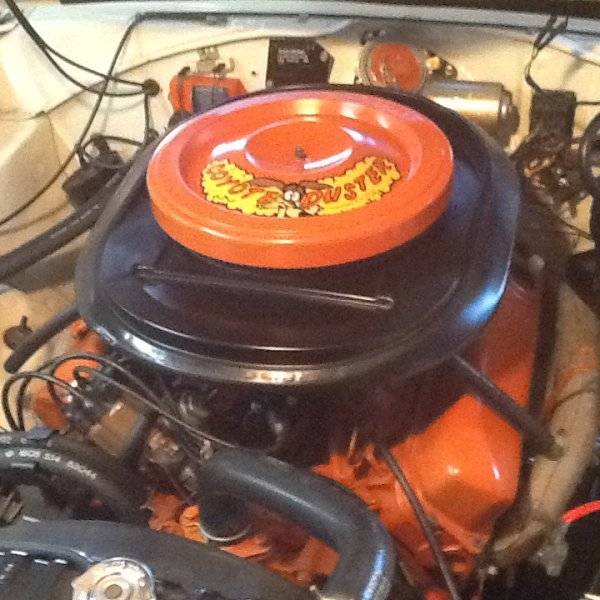

My hoses are the Mopar heater hoses ( originally I think Mopar had ribbed heater hoses) for drain hoses with lettering on. Length they extend by the exhaust manifolds. Breather is a ribbed factory elbow hose
If needed I can take breather hose pic and hose length measurements later just let me know
That would be great especially if it appears to be a formed hose i'll get an idea what to look for.
