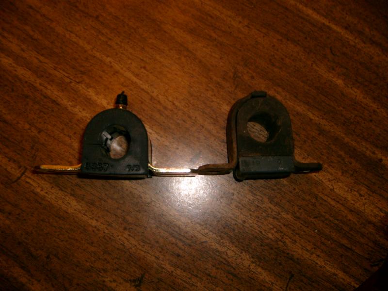

It's a 1971 Charger was trying to keep the original sway bar so ordered a Energy Suspension bushing and bracket. Well it won't work bracket will not fit into groove at mounting location and if it did bushing would not be tall enough. So does anybody know where I can get some replacement bushings? I got all my old hardware just need to clean them up if I can find me some bushings. You can see the height difference in them. So it looks like I have some extra sway bar bushing if anyone needs them.

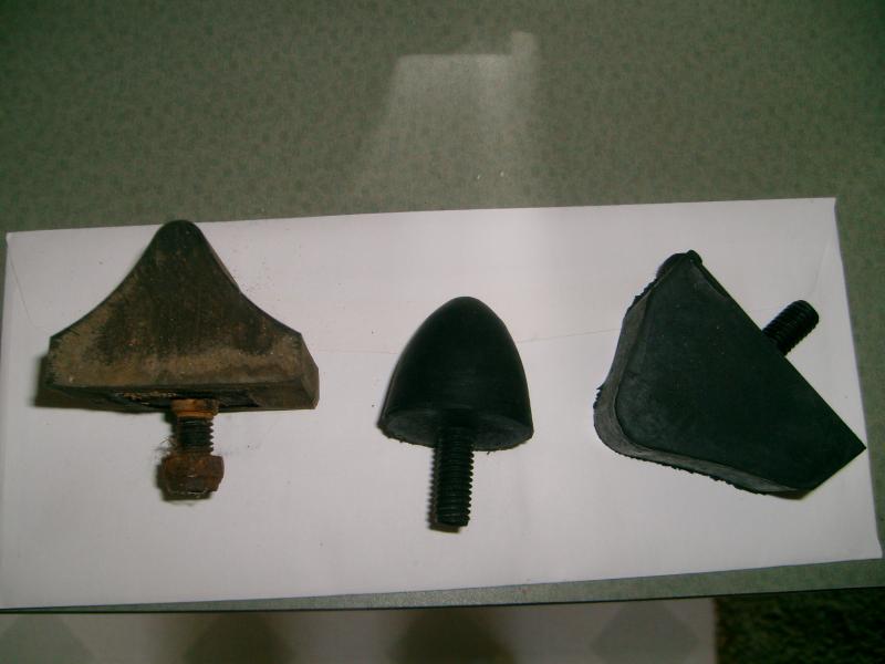

Also anybody know what these bumpers go to? The one on the left is what I need but the others are what was sent to me.
The bullet-shaped one goes on a frame bracket pointing up and the upper control arm rests on it when the front suspension's at full drop. I think the other one goes on the lower control arm, but I don't remember for sure.
Have you tried PST for the correct bushing?
Looks like PST has a replacement sway bar bushing. But I know I didn't remove any bumpers resembling those that they sent me.
