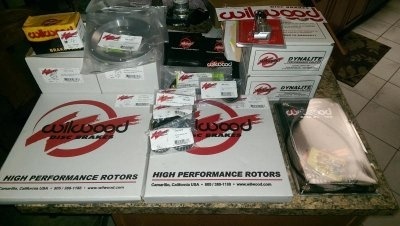

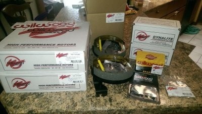

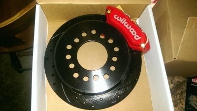

I am a new member with a 1971 Charger SE 383. Needs work but it is all there and runs great. Could anyone please suggest a good 4 wheel disk brake conversion kit that they did an upgrade on their charger? Seen so many and can't decide? While its apart I believe I should do a front end suspension rebuild. Any suggestions on a front end kit, poly or rubber? Thank you in advance for your suggestions?

Rear:
Wilwood 140-10767
Front:
Wilwood 140-11021 -d or -r depending on your liking
Note you must use 15 inch wheels and aftermarket repop steel 15 inch magnums need clearancing to fit the front kit.

I have the 15 in stock rally wheels? That will work correct?
Thank you I was able to get the spec from wildwood for the inner wheel size
