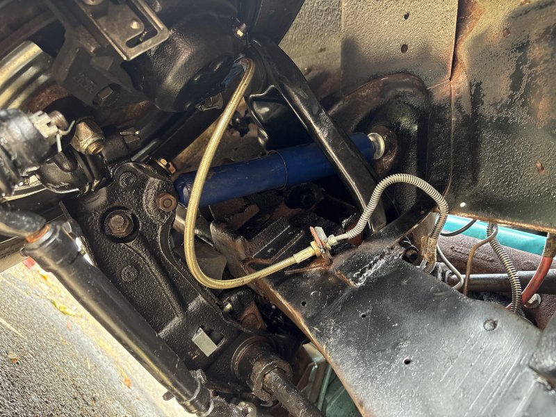

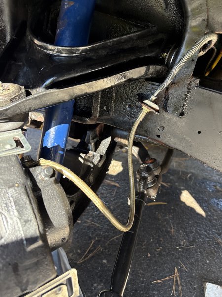

The prior owner had put an all around disc brake kit in my 67 Charger. I been working on it since May now and I keep finding problems with everything. Well, here is what I found today. Every so often when I turn the wheel, like say backing out of my driveway, I can hear and feel like something is binding. Feels and sounds like it in the dash. Well, this morning I set to find out what's going on. When I have the wheels at full lock the front brake hoses slip inside the rim and rub against it. I could never replicate the sound just by turning the steering wheel all the way back and forth, it would only do it in motion. I think what's happening is the hose when I pull out of my driveway and have the steering wheel all the way to the right, that hose on the driver side is catching the caliper. The kit did not use rubber hoses, they are braided, more of like a plastic braided hose. The kit for the front is from a 79 Aspen, and those hoses have a bracket that gets mounted to the frame somehow. I might just have to try a 12' rubber line with a banjo style. Anyone else have a problem with a disc brake conversion like this?

This is how it sits in the car. As i turn the wheel it goes between the rim and the caliper. The passenger side is down and wont catch the caliper but will rub on the rim. Im thinking a shorter more original line.
That's a known problem when swapping to a '69 or earlier b-body with rear-mounted calipers and sway bay tabs on the LCA's. This is a "Disc-o-tech" swap that was popular a number of years ago BUT with those known issues.

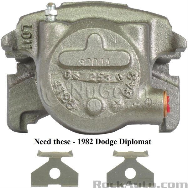

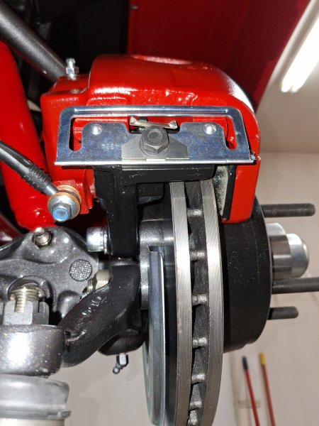

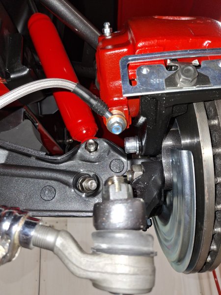

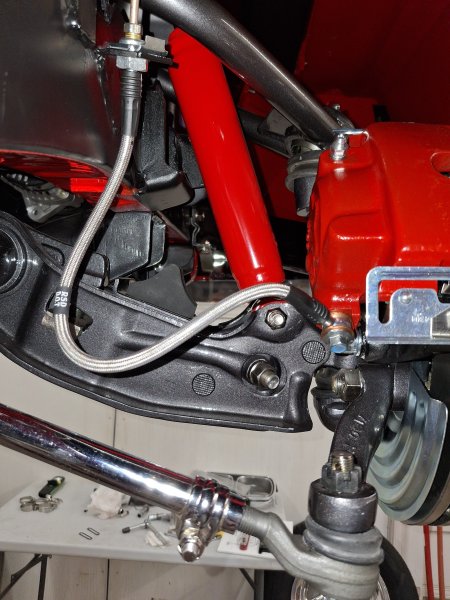

I've done that swap but used different caliupers than what you have. Mine are from an '82 Dodge Diplomat (Duralast C232 & C233) and the lines mount on the bottom and must mount at the angle shown. My hoses came from Dr. Diff. I have no issues.

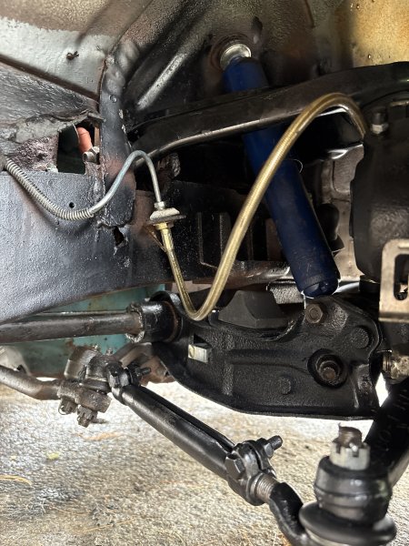

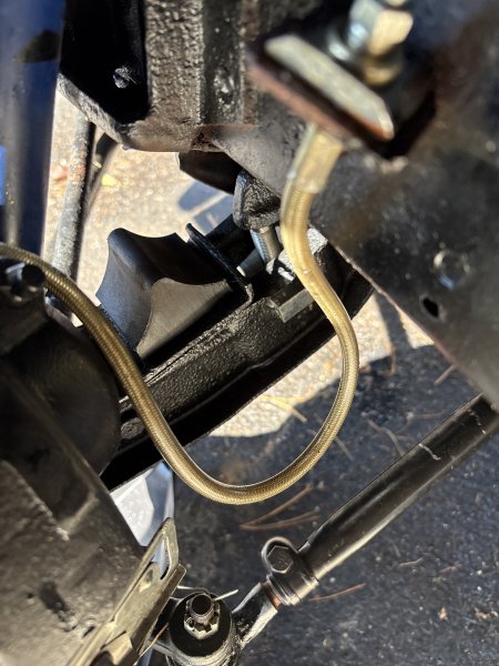

I tried to angle it on the driver side caliper to no avail. So I figured I would try and turn it around where it meets at the frame. I think it’s ok now. Doesn’t go near the caliper or the wheel. The passenger side fought me a bit. The best I could do was to have the line rest on the lower control arm when making a right turn. And that's at full lock.
All the way to the right.
All the way to the left.

How about resting on the lower control arm when making a right turn. I wanted to take a picture, but couldn't get under it. I might have to try and get a line that's a couple of inches shorter. That should bring it up enough not to rest on the lower control arm.
