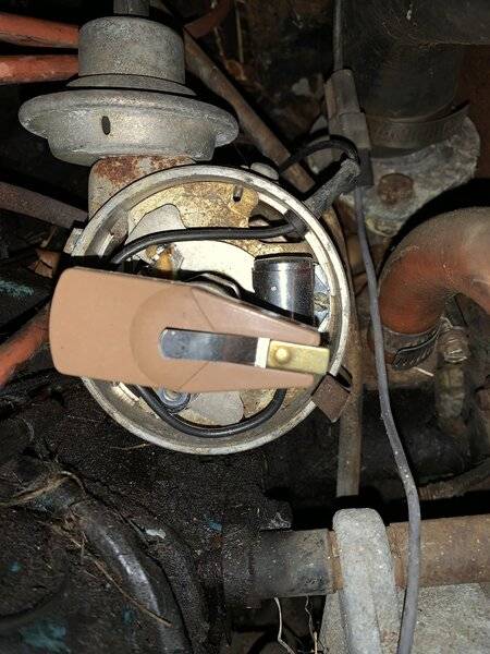

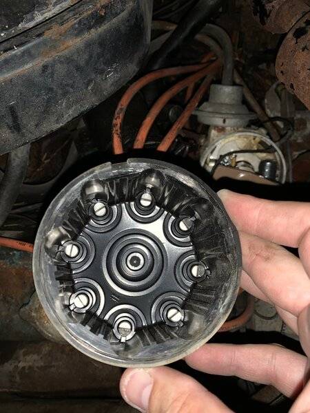

Under the distributor cap looks good. I usually hook an external gas tank up and bypass all the nasty who knows what stuff in the actual fuel tank and lines. I go external gas tank to mechanical pump, to carb. The pump works but unknown what the carb is like. Ive poored gas into the carb with no luck so far. Close but no cigar yet.
Looking good under the cap doesn't mean diddly-squat, your gap could be out to lunch, bad condenser, etc.! Oh wait, 71's got elec. ignig, but still check everything thoroughly! If you haven't done the external tank yet, do it and see what happens. Your filter could be gunked up too? Looking down the carb as you go blip the throttle to full throttle, do you get a good squirt of gas into the carb with the tank or external tank?
How many times & how long have you been cranking the motor to get it to fire? You still may need more prime in the carb before it will fire?
I can't think of much else? Good Luck
