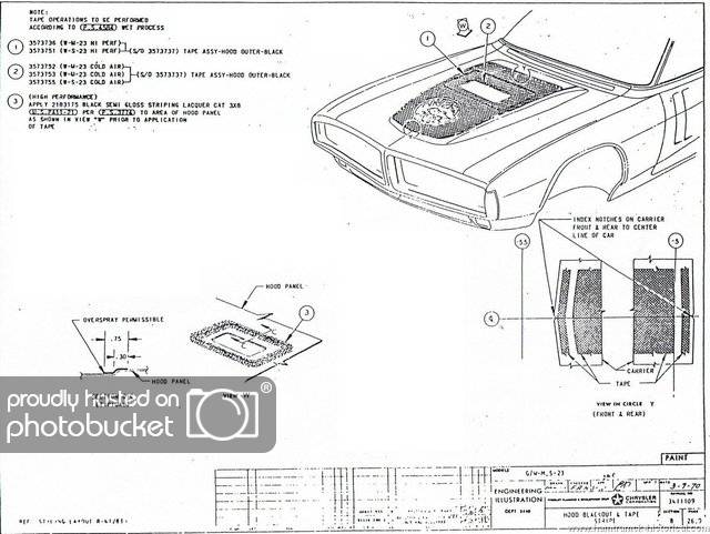

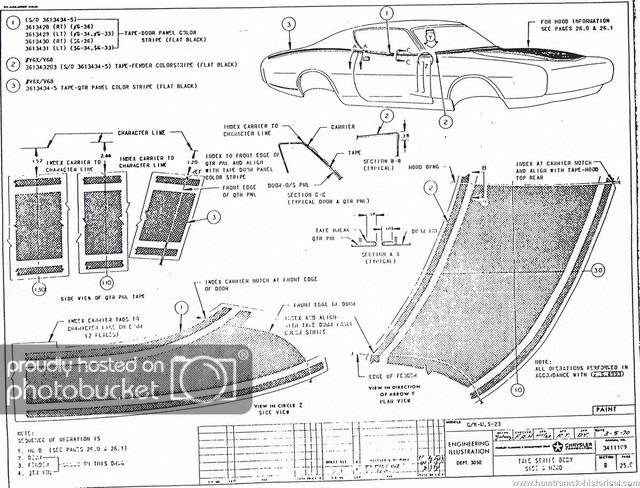

hello all
looking for measurements or exact proper placement for side longitudinal stripe for a 1971 charger
Maybe this will help, Ill be doing this soon also.
