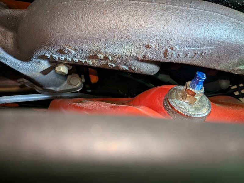

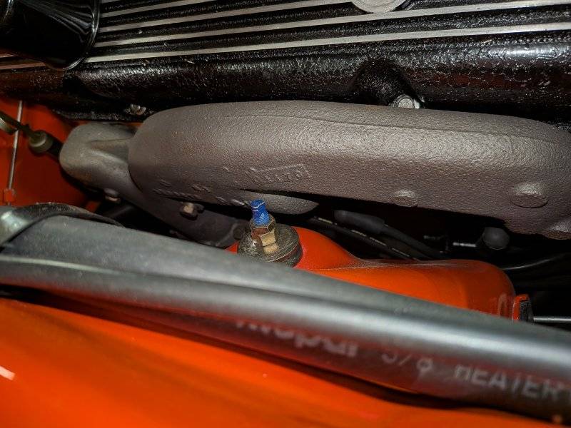

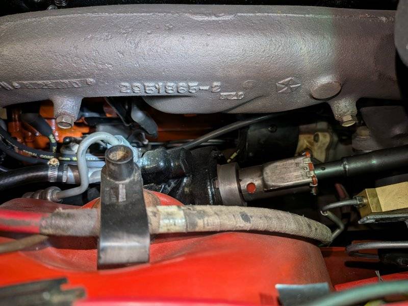

Examples of the manifolds are in the following pictures from my Challenger.
2899879:
2951865:
