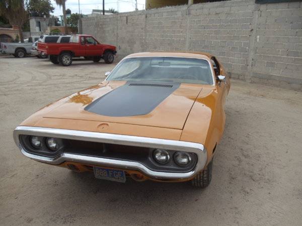

Hey guys not familiar with installing glass on my 1971 Roadrunner, does this type have the gasket that goes around then installed with 3/8 starter rope or is it glued in someway?? if glued in can anyone tell me how to do it, thanks guys, appreciate it
