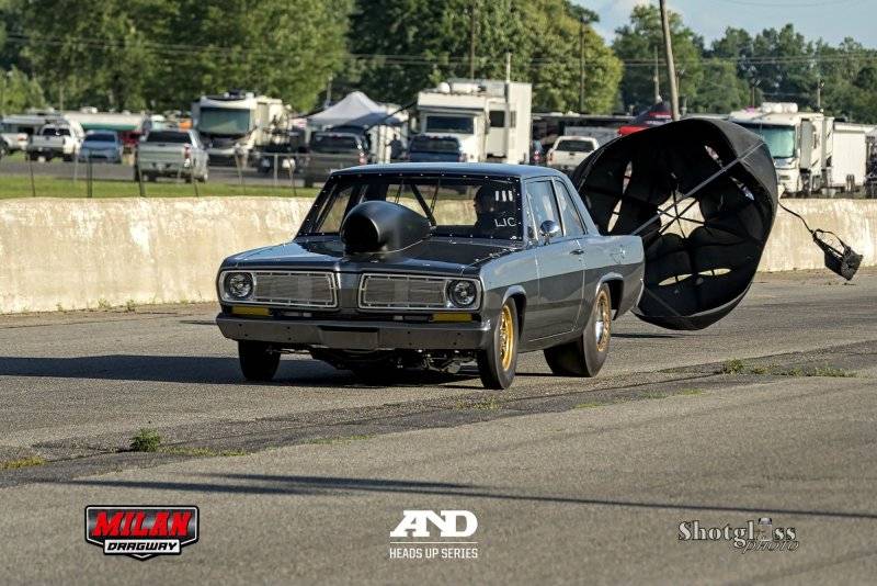

Is this your car? If so, that's a flat plane of glass more or less and not as sloped to be slippery. I would think that the base by the scoop creates a vacuum of high pressure at high speeds along the center bottom edge of the glass.
Yessir. It's got some decent arch to it PLUS I added a little (because I could! and thought I ain't gonna hurt aero) The scoop is sealed everywhere around the carbs and the scoop lays on the windshield with a rubber insulator. FWIW the distortion from impact winds is prevalent at the roofline in the center of the shield.

Thank you, I made it about as light as I could afford both out of pocket and time expenses. It has steel doors yet too. I had to add about 150 (and I have weight bolted in a few places to be class legal at 2825lbs but I always ran it about 15 over just to be safe. (I am about 220 dressed.) It just got upgrade to 25.4 by my buddies at SteffCo so that added 60? pounds. Not every Valiant is this light, Alguire had one years ago that was 3400ish with him but, he didn't chase lowering its weight. One thing to add was On my first pass over 140 the pass side door window blew outward at the top. I don't seal it at the top anymore AND I lowered the top of both windows to help vent the interior press.
