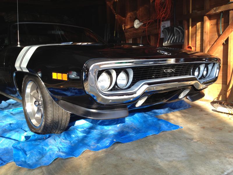

I restored my GTX grill awhile ago - to my understanding, the black section wasn't painted, it was just black plastic. The plastic on my grill was beyond cleaning up, so I used Krylon "Fusion" Satin Black and a generic argent silver for the rest. Krylon's Fusion paint is made specifically to bond to plastic, and the satin black color has a nice sheen to it, similar to a semi-gloss (basically looks like new, black plastic). I know guys have had good success duplicating the '71 silver color with non-textured light argent paint from Totally Auto.

Like rrTor-Red said, take your time with the prep! It took me awhile to tape everything and is tedious as hell, but it was well worth it. Here's a pic of mine from this past fall...
Good luck, man!

Love that two tone making think of doing the same thing to mine once I'm at that point.
Thanks for chiming in guys. rrTor-Red - Yeah - The taping task is something that really looks like a pain. Its good to hear that you're happy with the results. My grille is not bad, but just not good either. I think I'd be really happy if I took the time to do it right.
Thanks for the paint recommendation and link GTXplicity. Good to know that the black 'could' clean up to look better. I'll give it a try and see if I like it. That would be an ideal first step. Looks like I have some silver / argent to pick up!
