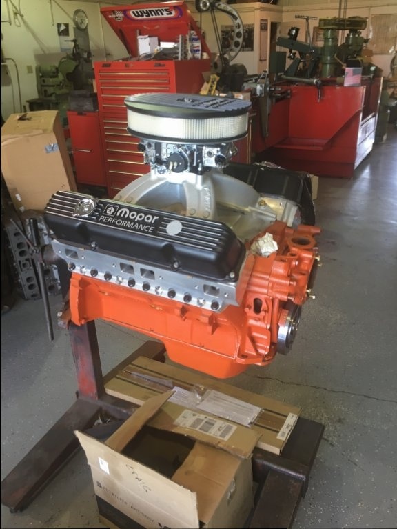

I may have screwed up and need some information. I let my engine builder choose my intake and didn't think about hood clearance. I have a 440 with Edelbrock Heads and Victor intake. I have an aftermarket air grabber hood setup and after seeing the height of the setup, I am thinking I need to swap out to a different setup for the intake. Can anyone with an air grabber setup comment on the clearance?

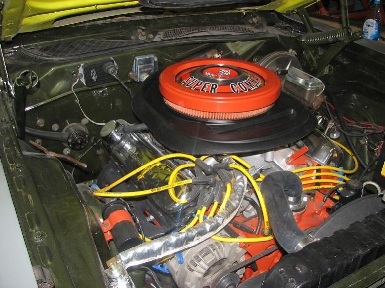

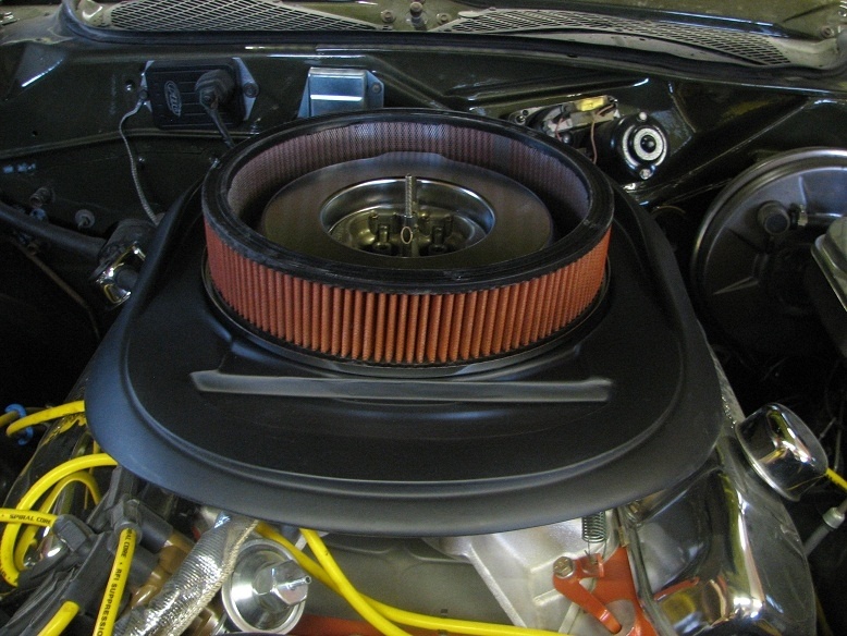

I have a 71 with a 440, Stealth heads, performer RPM, and factory air grabber. and I did make it work with modification to the air cleaner.
I used a fiberglass reproduction air grabber base - removed the middle part and fabricated in a drop-element air cleaner base in its place. 13 inch Ford Motorsports has one. Wouldn't fool anyone and that isn't my intent. But I do like to be able to restore the function of the grabber and get back to a stock-like look.
There is not much clearance between the base and the stock lid - maybe 3/4 inch where it dips. I could probably shave a little off the horn to get more clearance. Another project for another time.

I talked to my engine builder. He is going to swap it out for the Performer RPM manifold and since my Air Grabber is all aftermarket, I have no issues modifying the setup to make it work. I would have loved to kept the Victor manifold, but I have too much into the Hood to turn back. Thanks for the feedback!!
