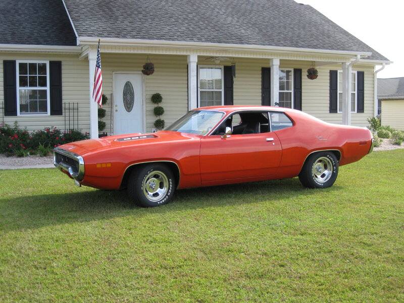

I measured a lot on my 71 Road Runner and as Mark said 275-60/15 on the rear with a 15x8 and 4.5 back space. Front 245-60/15 on a 15x7 4" back space was perfect. Pics when I get home.

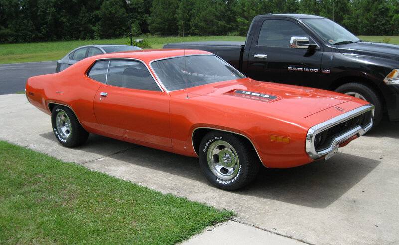

I have 15x8s (4.5" backspace) in the back with 265 60 R15 tires and 15x7 up front with 245-60 R15 tires (4.25" backspace). I would have done 275's in the back but I had to go slightly narrower because I have a small wheel spacer to clear the disc brakes in the back but it fits exactly where the 275's would if there was no spacer. I personally think they fill the wheel wells out very nicely.

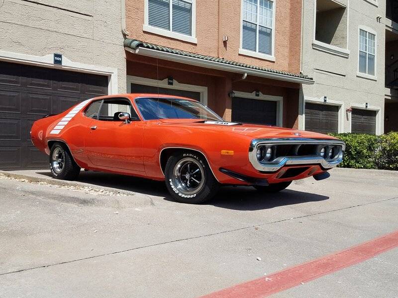

Pics
Nice pics, thanks for the info
