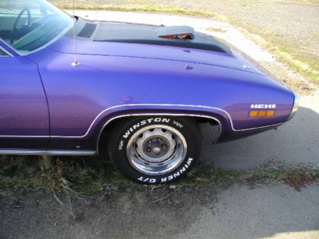

Would anyone know the correct placement for the decal that goes above the front side marker light? Thanks
Picture of my old 1971 Hemi GTX if it's of any help to you.

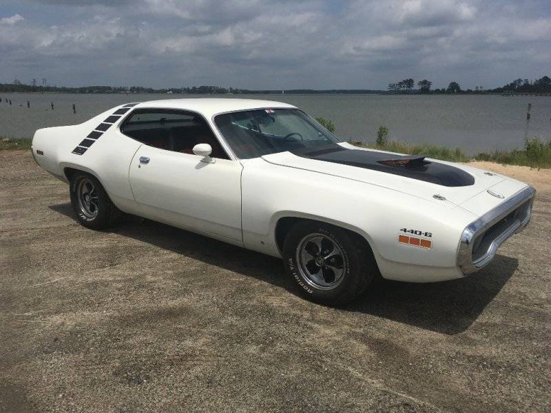

Picture off the web shows the same layout as hemi71s

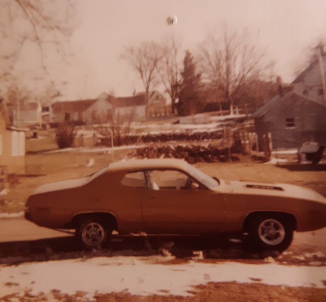

My 71 was a 340 car stripe delete but still had the bird on the qt.
That Pic is 1980 or 1981 and the car was original paint at that time. Crap pic but you can see the bird if you enlarge it.

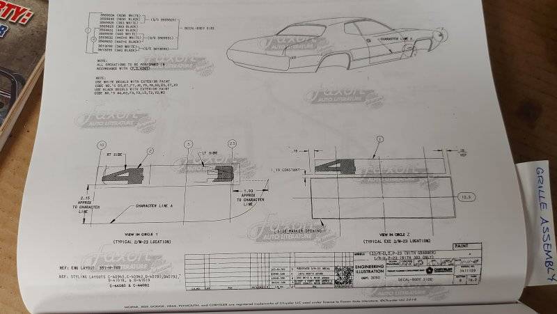

Ask and you shall receive.
Got all the info from this book.
Here's the factory drawing.

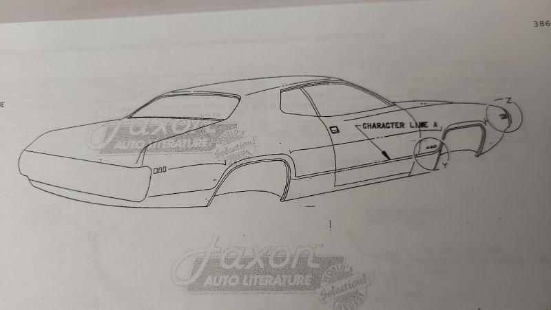

Here's a close-up of where the decal is located, but you already know that.

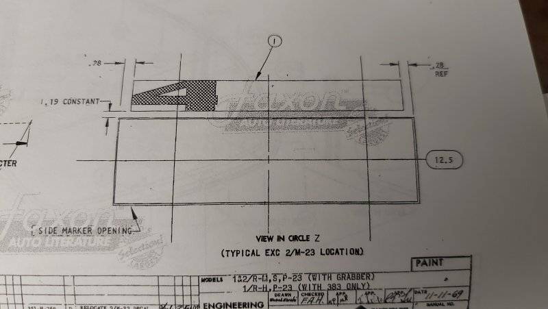

And here's the dimensions used that are taken from the side marker opening.
