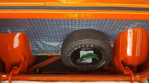

Can someone post a pic of how the jack is assembled in the trunk of their 1971 Roadrunner, also what color should the individual pieces be, thanks guys

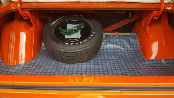

This should help
got it rotated... duhhh
The mat is herringbone on 71 roadrunner??? The hook is green?? This is factory correct??
That is what was in mine, which I bought from a one owner worn out original car. mat my not be 100% correct but its pretty close to my original got it from DMT, stay away from REM stuff.
I've seen the '71's as in the picture page5 posted, haven't seen a different version. Yes, the hook is green. Closest green, if need to be painted, is John Deer green
My hook still had decent paint on it and for my hook I thought the Rustoleum Hunter green was a closer match than the JD green. The JD just seemed too bright to me. I'll post a pic later.
