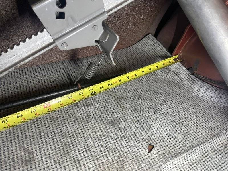

I’ve asked some questions regarding my new floor pan and have gotten great advice on here which I appreciate.
I now gave a question regarding my new AMD floor pan that I added to my car as the original trunk pan was rotted away badly.
I’ve got a new jack bracket and jack spring loop by AMD to weld to the trunk pan on the drivers side of the trunk floor.
Can someone help me out with a photo or even better some measurements on where these should go?
I’m wanting to get them as close to factory locations as possible so that once I paint the car and buy a new trunk floor cover the cut outs for the jack bracket and spring loop will line up.
Your avatar is a little bit fuzzy to me. Your Charger is a 1968 model year?

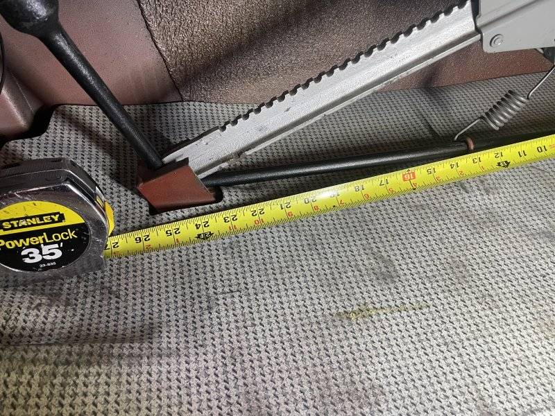

Here you go….

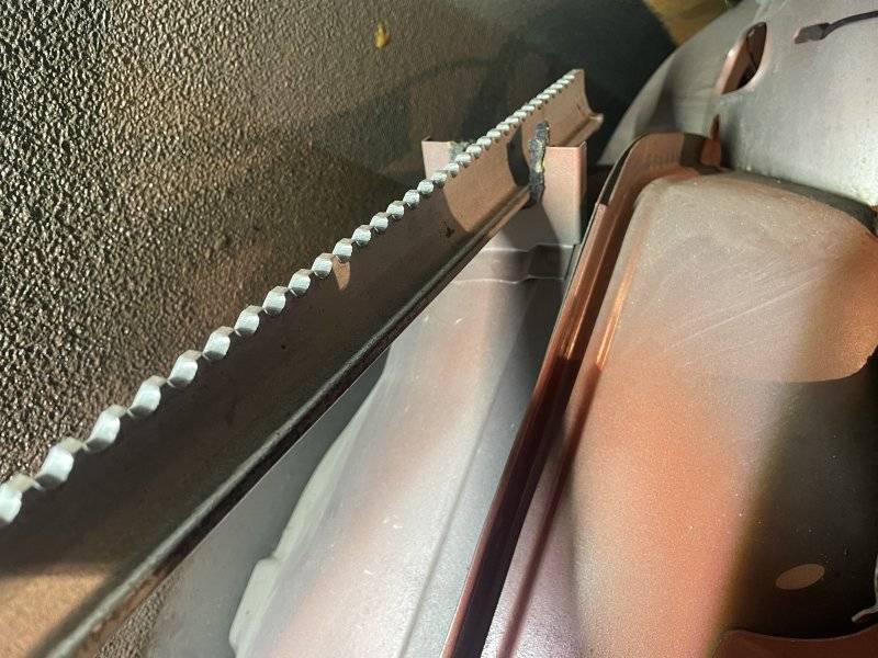

Don’t forget this bracket and piece of felt.
