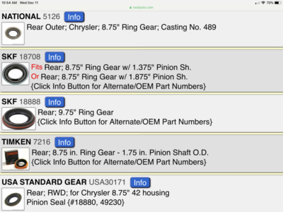

A 489 is 1.875 diameter, or 1 7/8
A 741 is 1.375 diameter or 1 3/8
These both take the same pinion seal. SKF 18078
A 742 is a 1.75 diameter or 1 3/4
Look it up on rock auto and you can see they list the seal by the case number or the decimal numbers above. Not the fractional numbers.
