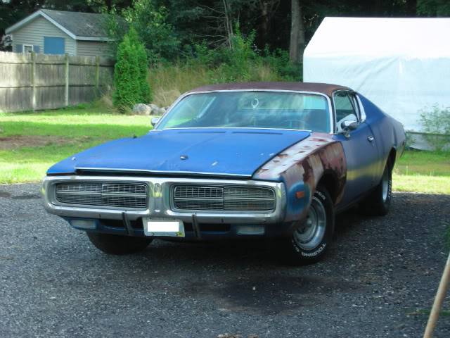

I know she's not pretty but I figured I'd add a photo anyway.
Hey, It's not Bad, It will buff out! ......I have seen much,much worse !
BTW, cool hand cuffs on the rear view. :cool:
ouch! Welcome, I say Ouch b/c RI cars are in sad shape, especially our older ones! Look at my GTX; it was a RI car, I won't go that way again! Be careful, and good luck on your build!
