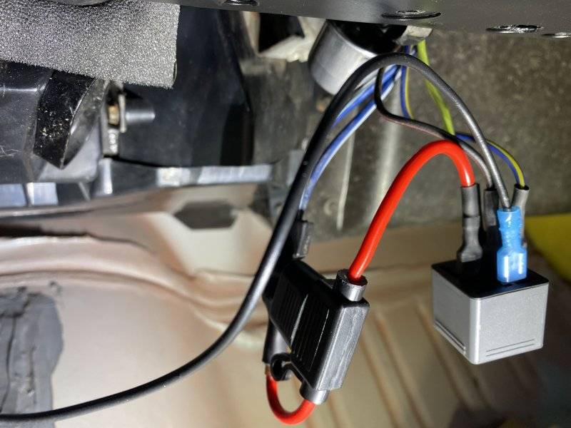

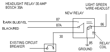

Get a new Bosch and wire it up like pictured. I went with an inline fuse vs the factory circuit breaker. Cheap and works great.
the one that is there now, under dash pass side, makes a lot of weird noises, smokes a little sometimes and the headlight doors randomly open and close when lights are on
