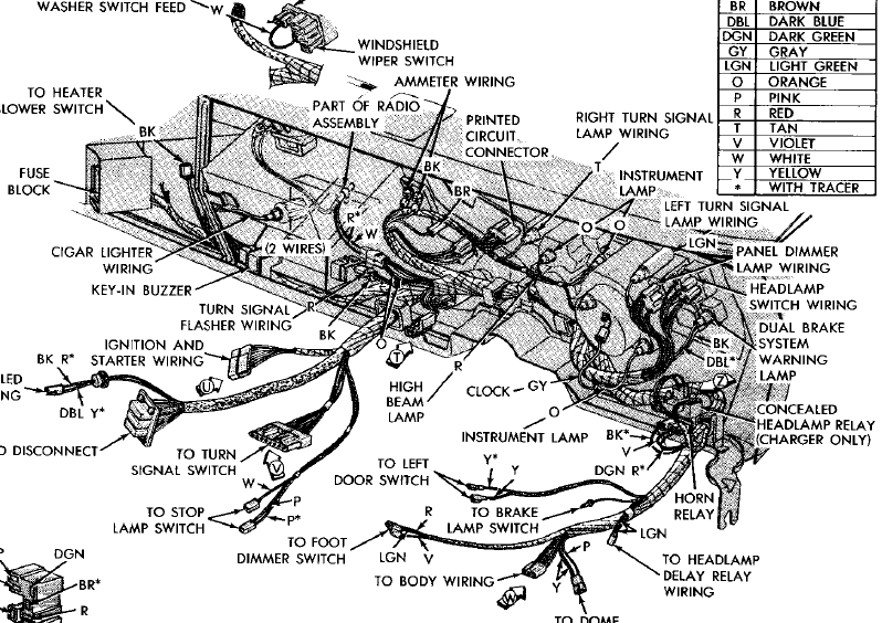

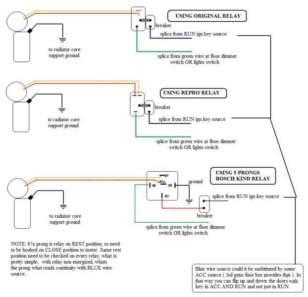

Trying to find the headlight door relay on a 70 Charger. No luck with the Haynes manual. Please help.

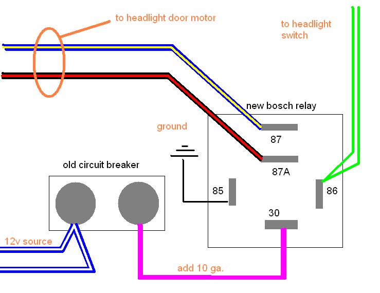

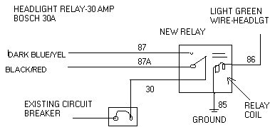

Can you get them still, are they being reproduced or is it better just to use a newer relay?
