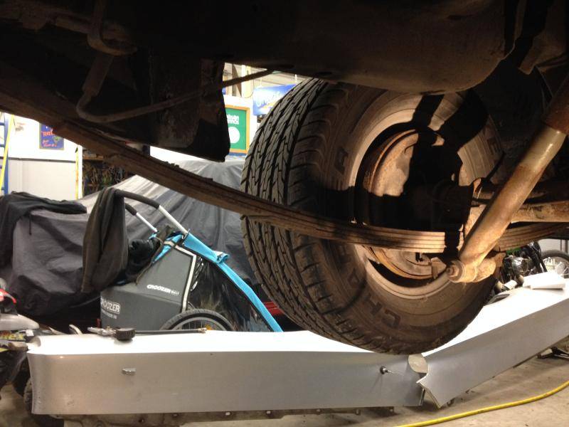

Ok that is the 72-down spring mount. Here is a pic of the 73-up mount.

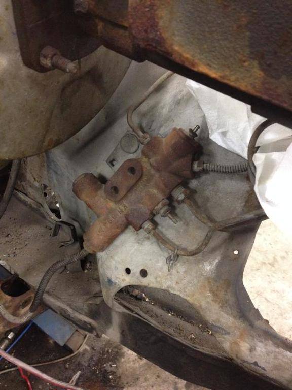

Have no idea what the master cylinder is from.
That is the 72-up port valve.

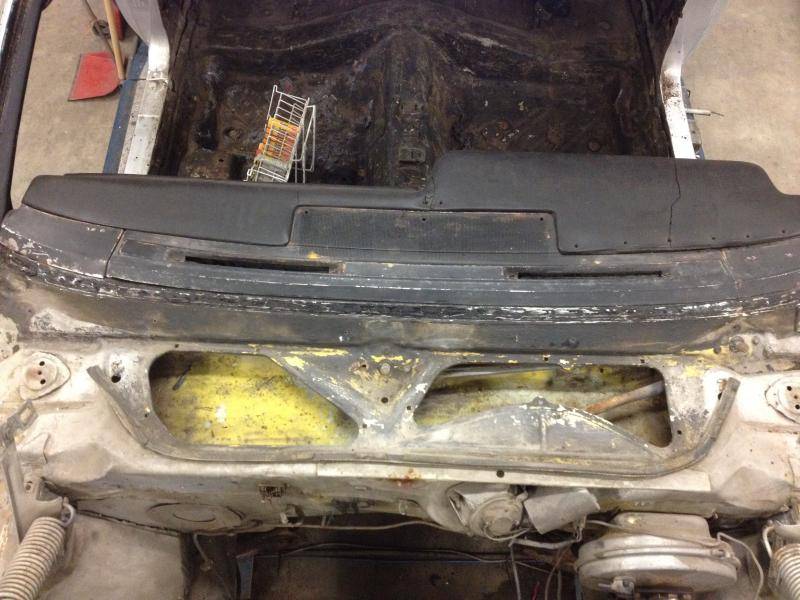

Kind of looks like maybe someone put a 73-up front clip on your 72. Would need to see the welds where the fender wells meet the firewall, top of the floor pan as well as where the cross member welds to the rockers.

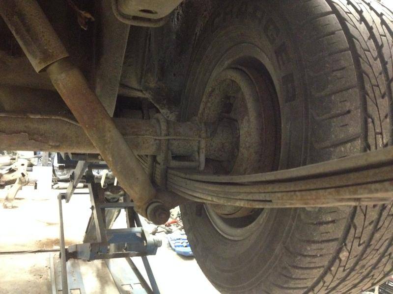

Also that is a 72 rear bumper and tail lights.
