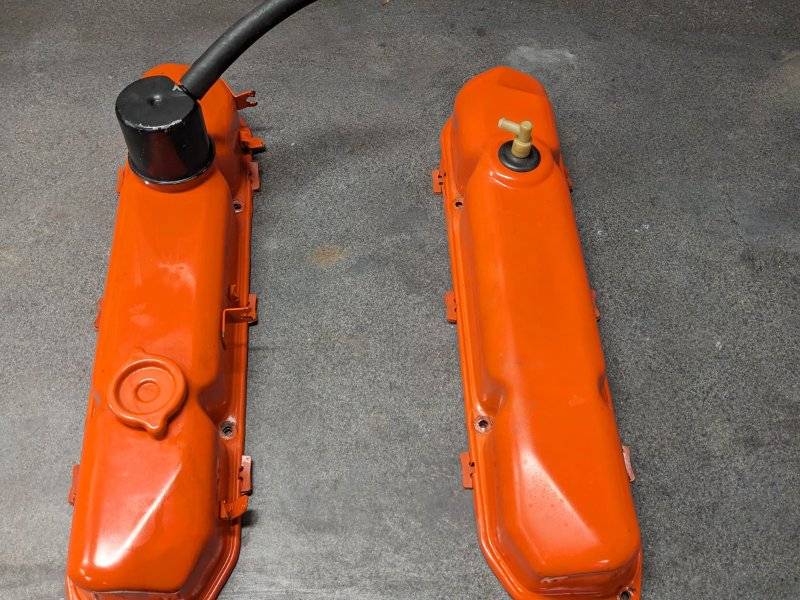

The following image shows my stock valve covers with grommets and oil filler cap.
The following image shows my stock valve covers with grommets, stock crankcase breather, later model Mopar PCV valve, and oil filler cap.

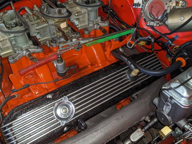

The following two images show my ~1970 440 engine in my T/A Challenger with Cal Custom valve covers but with the stock style grommets in the approximate stock locations and my routing of the PCV hose (which is not quite like factory) to the Mopar PCV valve. I use the stock crankcase breather on this. Note the oil filler cap on these is on the driver side, unlike factory.

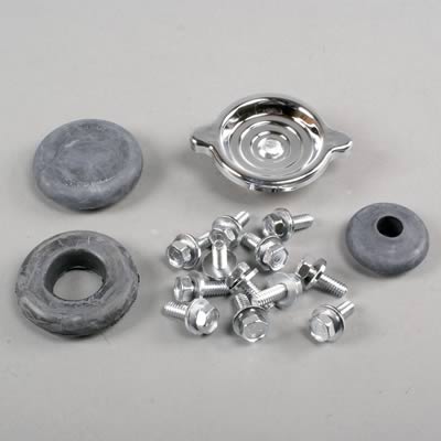

These grommets were also available with a chrome filler cap, chrome bolts, and plug for late small block truck truck valve covers in Direct Connection/Mopar Performance number P4120272.
Look at 72RoadrunnerGTX pictures above, he shows exactly what you need. The valve cover you show is wrong with the wire holder at the rear.
